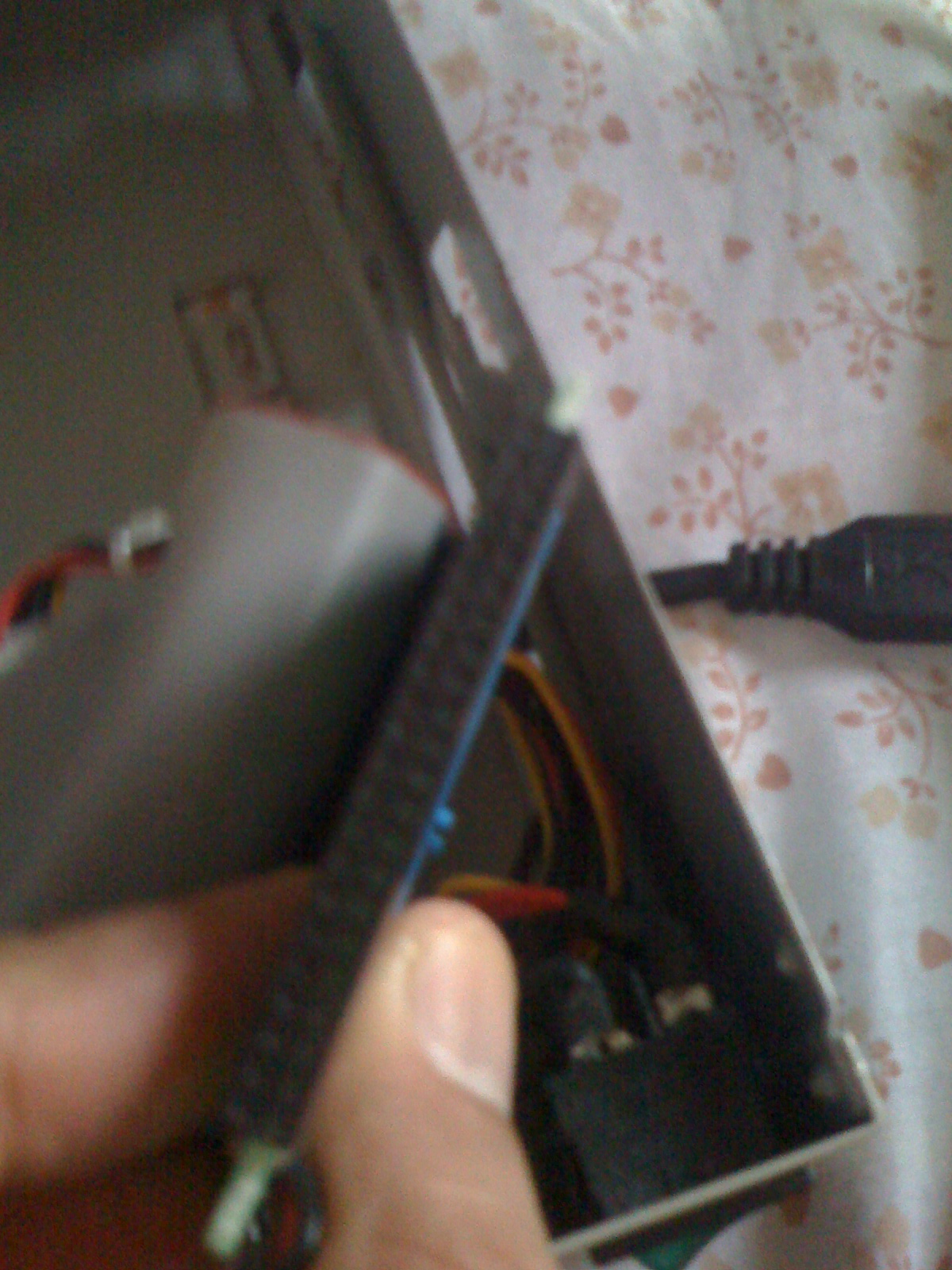

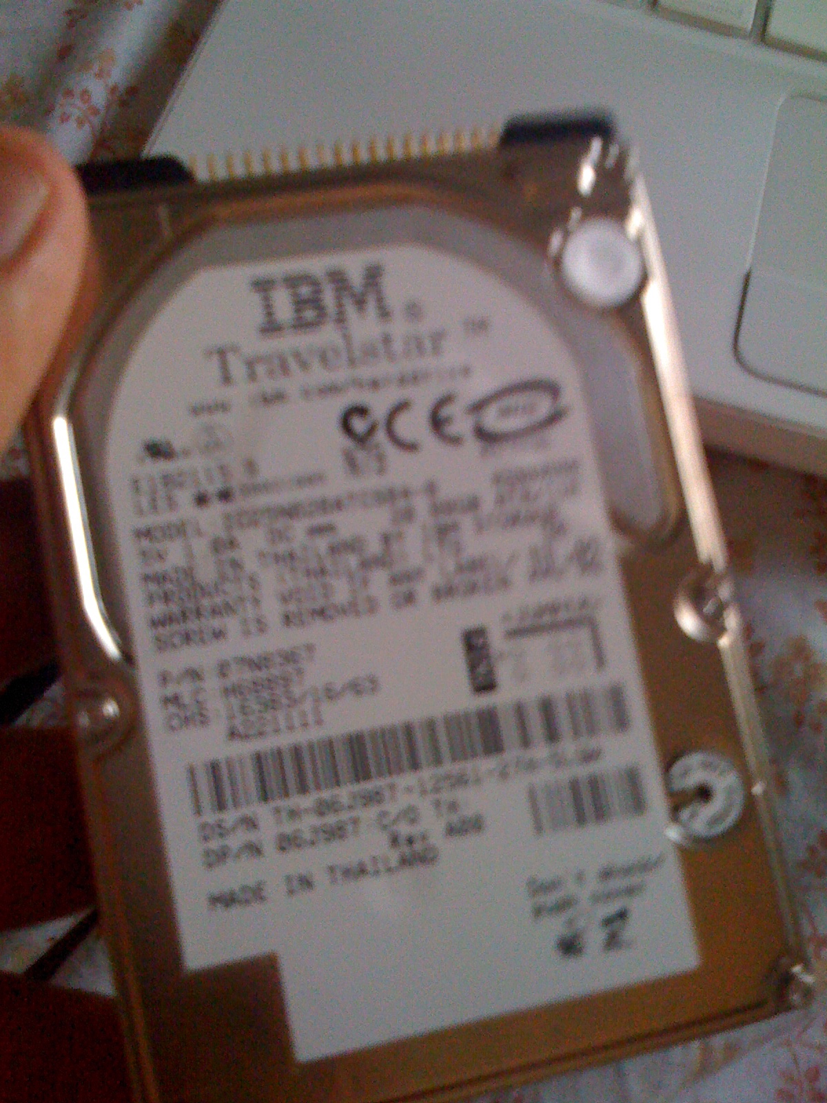

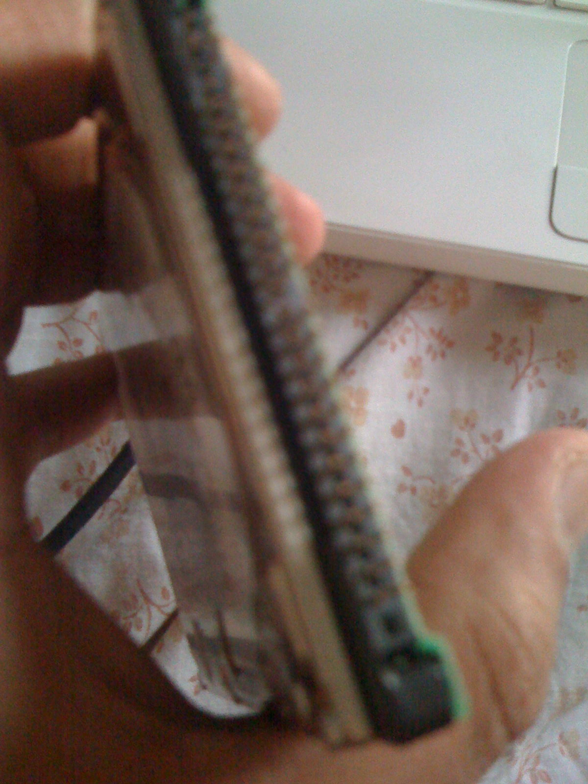

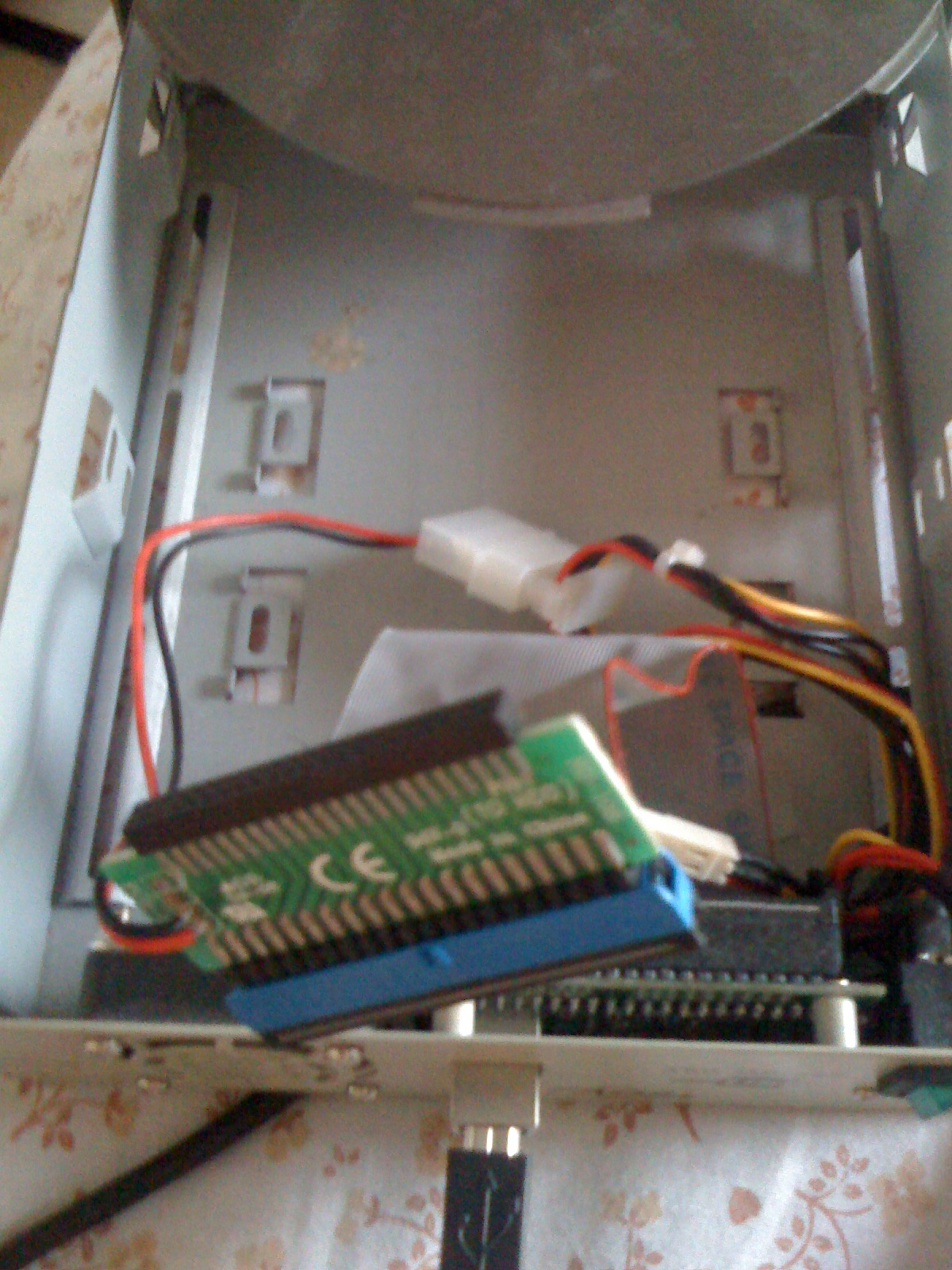

OK guys so I have this hardrive connector that I got from my friend and I have an internal hard drive. The Ide i connected through USB .. I am trying to get mac to read this drive please help
Pics below

One problem you MAY have with that is the fact that it's an IBM drive - they lock if they're configured to do so when in a computer. If you know your drive is good and available for use, you should be able to just plug it all in (just the IDE ribbon cable inside) and the USB outside and if it spins up, it should be recognized.
Does the drive enclosure have a power supply or is it only the USB connector? Is the USB cable by chance a Y-shaped cord with one USB plug on one side and two on the other?
I don't hear the disk spin .. I have 3 hard drives none of them do
EDIT: Do I need to make it a slave drive ?
That case has a power adapter and a cooling fan - the hard drive doesn't require external power but the case may due to the fan.
Honestly, it's tough to tell remotely. It's a used case and a used drive so we don't really know for certain that either is truly operational. Just by looking at the enclosure it appears as though it should have an independent power supply. The drive is pretty basic - just one ribbon cable. No jumpers or anything required. I have a few of these myself that I threw into a small enclosure but none have fans or require power - simply USB and they're bus powered.
