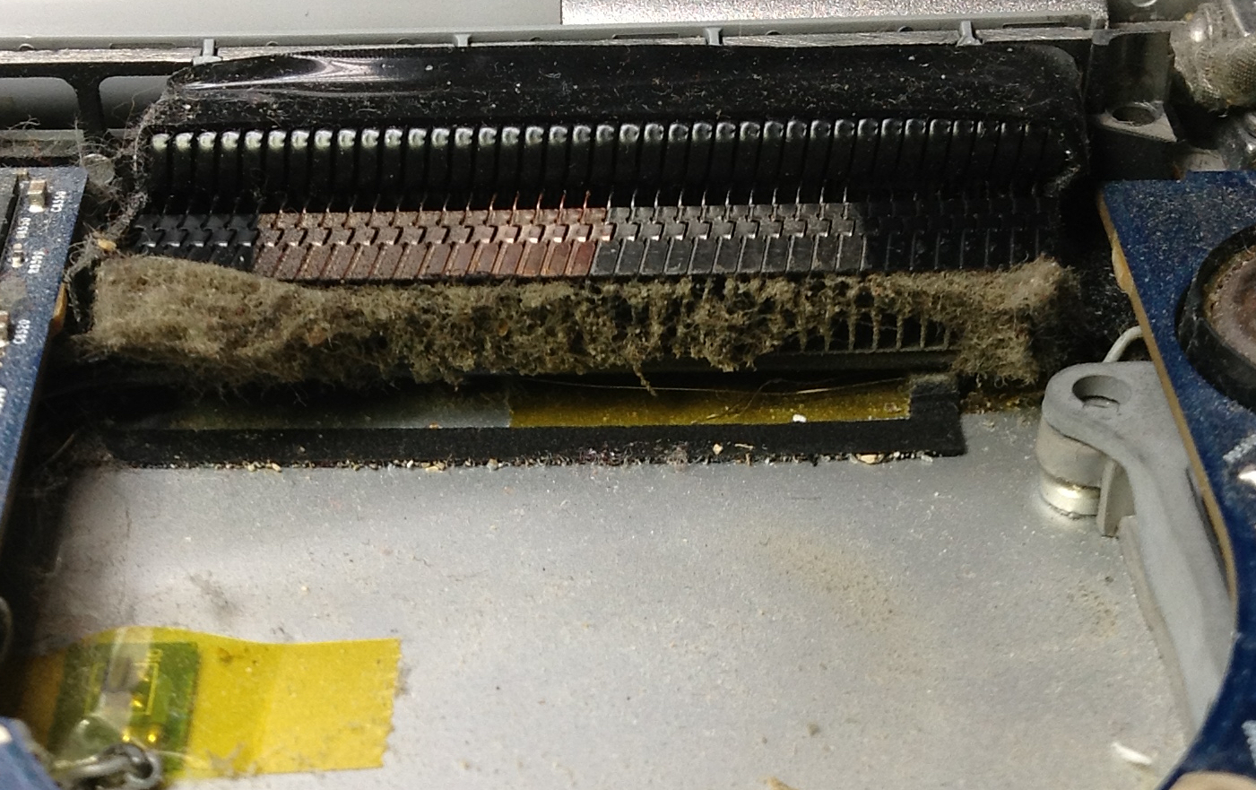

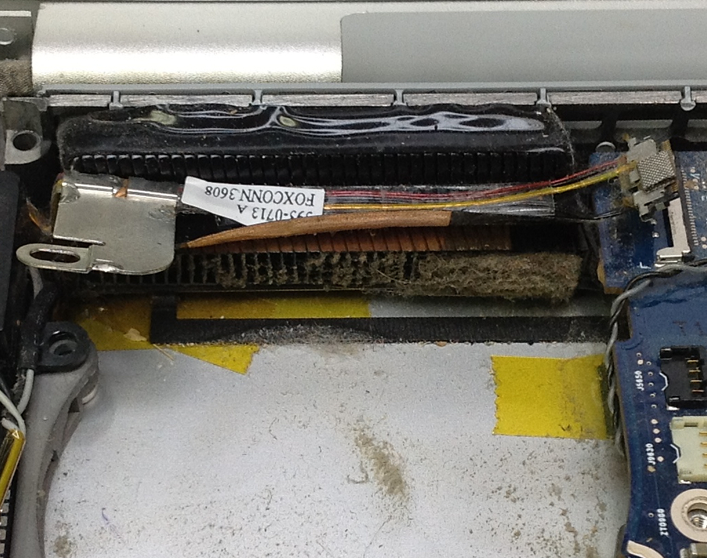

I see dust getting into peoples laptops and causing an overheating issues quite often. Usually it is not as bad as this, but believe or not I have seen worse. Below are the photos just for kicks.
PS- I think its more then dust, but also carpet / blanket fibers. This happens when people put the laptop on the bed, the fans suck in particles and the particles are too large to exit the vent.
Below is the left vent
Below is the right vent
