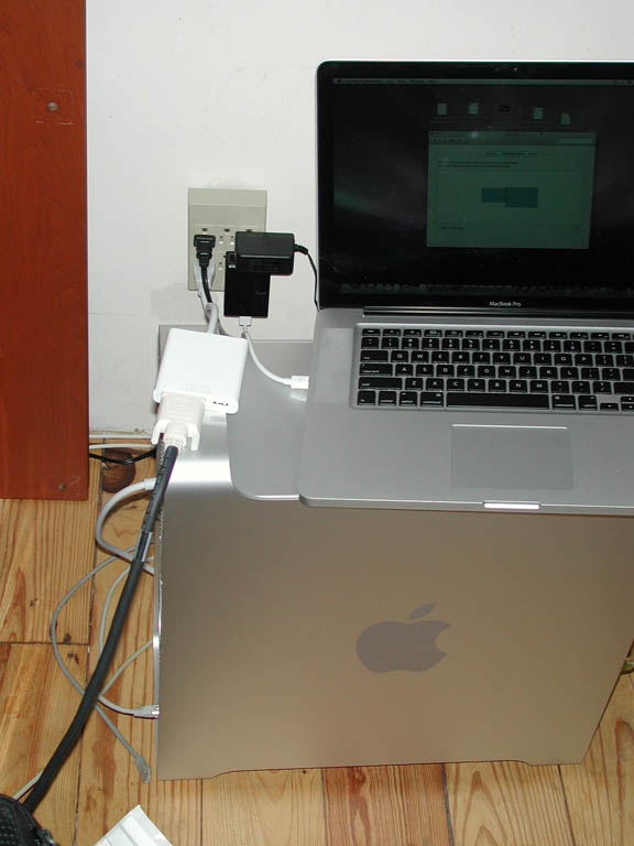

It works!
Hey, thanks for the idea!
I plugged the USB cable from the adapter into one of these iLove Power Kit for iPhone & iPod - Black and it works!
as you can see I have two monitors in the system prefs but no USB ports being used up....

Couldn't you buy a cheap iPod Charger and plug the USB cable from the Dual-Link DVI adapter into that?
Save you using a USB port on your Mac, and you can easily buy a 1.5M USB extension cable for $10 if the USB cable isn't long enough to reach a power socket.
