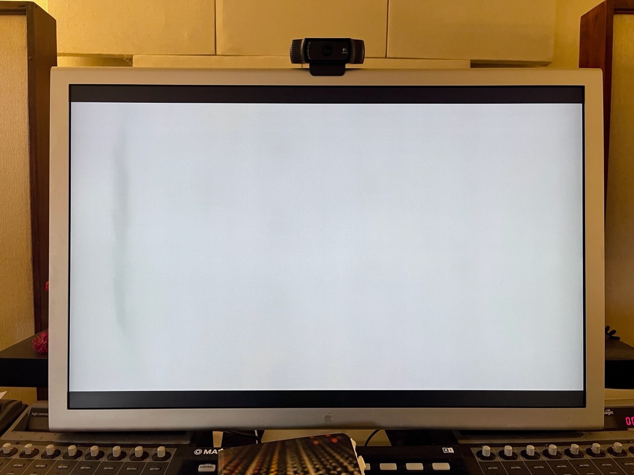

Also - does anybody know how to get rid of a 'smudge'? I assume this is pressure somewhere?
I actually sold the 'warm' ACD and have kept the 'good' one, which calibrates pretty well. I have noticed that the right side of my screen is ever so slightly warmer than the left - most people wouldn't notice, and it's an old screen now. I suspect this is down to age and tolerances.
But the smudge on the left is distracting, it doesn't show on all colours, and is a quite exaggerated in this attached photo vs real life. Maybe I've just learned to ignore it.
Given the amount of power the ACD30 uses, its' probably best to sell it and move on...
