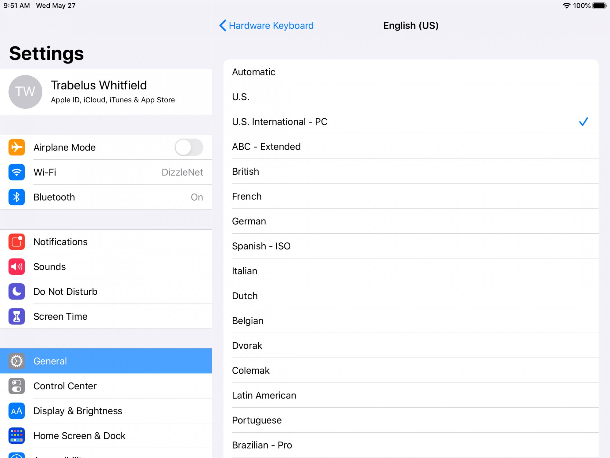

Go into settings/general/keyboard/hardware keyboard. Assuming you are in the U.S., change the keyboard from Automatic to English (US), even if it already says English (US) with “Automatic” in the right margin. That will bring back the missing ‘.
Thank you! That fixed it.

Going to SETTINGS/GENERAL/HARDWARE KEYBOARD worked for me, but I didn't have the "English" option on mine, so I had to choose US International PC (because the option that only says "US" didn't do the trick). That solved the problem for me. Curiously, I switched back to automatic shortly after and I had the apostrophe and the ampersand key available again. So it seems like you might be able to fix it by switching it to English or US International PC (because US didn't work for me) and then switching it back to Automatic, if you are someone like me who likes to keep things the way they were.
