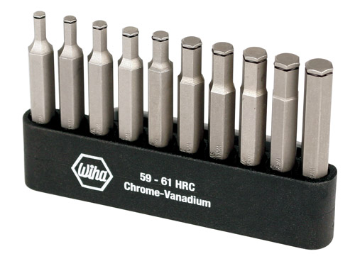

2. If your replacement drive didn't come with mounting screws, you'll need to take 4 out from the default drive. For these you need a small hex-head screwdriver, like the extreme left one in the picture I've attached for you below.
I didn't know about this, I thought the mounting screws were standard Philips head, so I had to scurry about trying to find the right one, all the while leaving the internals wide exposed for my cat to come and investigate !
