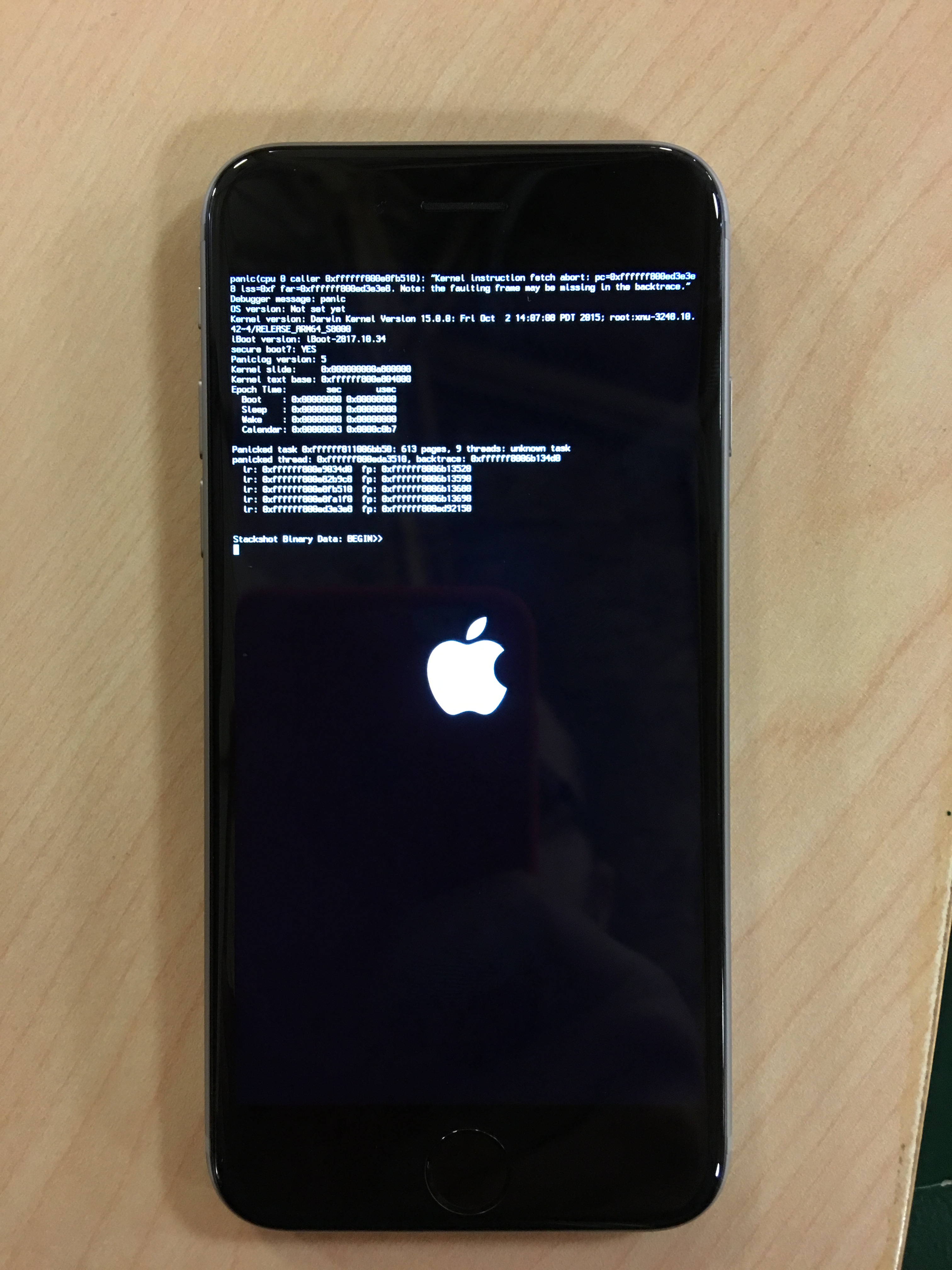

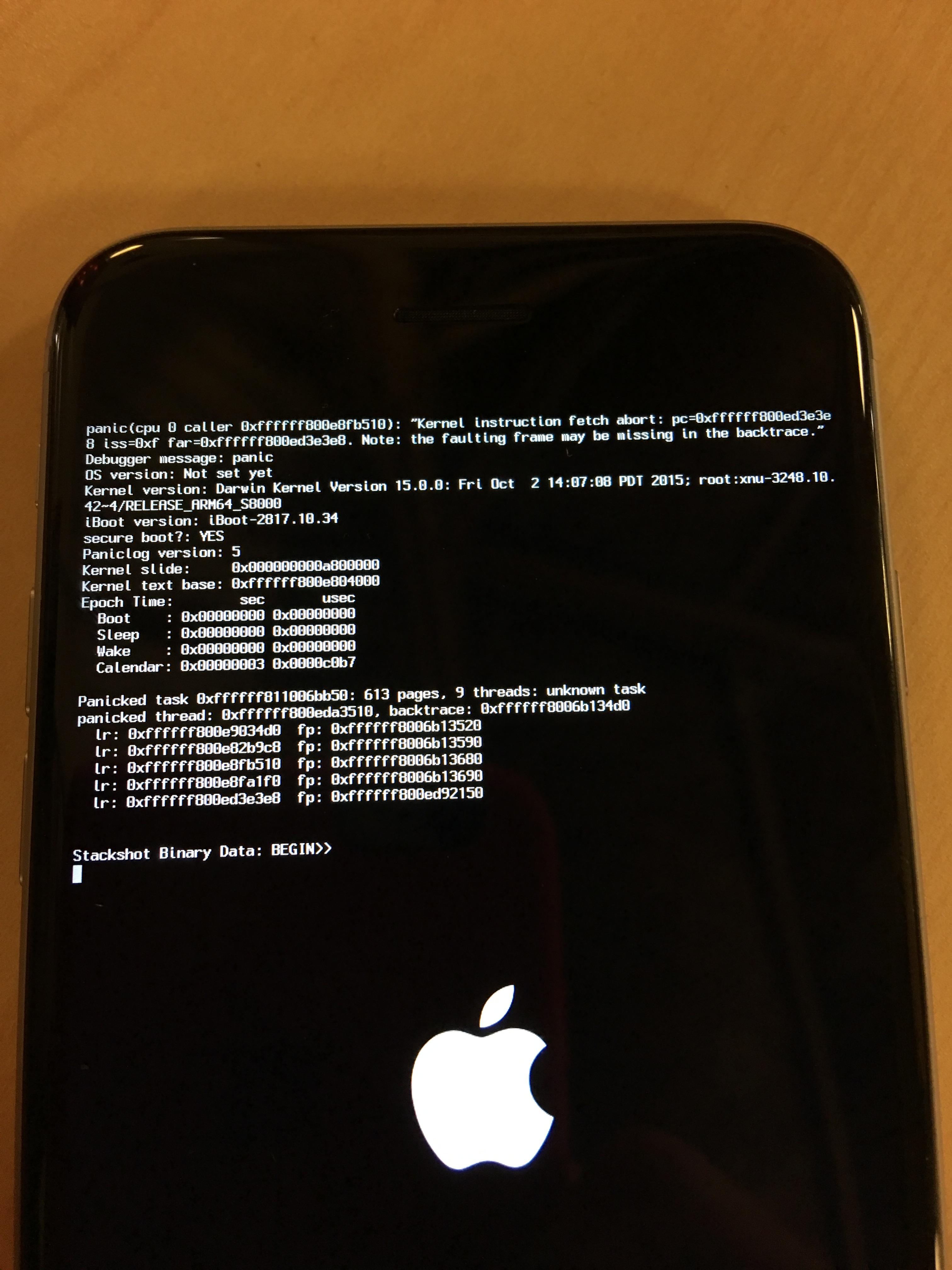

A co-worker of mine just got her phone about a week ago, 64gb 6S and all of sudden today it started to restart itself, so she hard reset it and this is what has come back on the screen. I have reset it a few times and plugged it in, nothing is reading it. She is still within the 14 day return period so she is just going to see if they’ll swap it out for her. I have never seen this before but in all honesty… I think its pretty cool, not for her but it looks like it wiped the os completely.

iOS is very much like OS X. That's a kernel panic on boot. Try restoring the phone. If it persists then it's probably a hardware fault.
You are seeing the code that results from a kernel panic.

Try to do a full restore.

Try a regular restore through iTunes. Then try DFU mode restore if that doesn't work. That's a kernel panic, phone is failing to boot as a result. Clean DFU mode install will give the phone a new OS, so if something got corrupted with the last one somehow which is causing the kernel panic, that will essentially be wiped away and replaced by a new, properly functioning OS. However a full DFU mode restore might not be necessary, but yeah. Just thought I'd give an explanation.

Just return it. ignore the one who say to restore it as I would never trust the device after it did this. If you are within your 14 day period, Apple will give you a brand new phone.

If an iOS device is having hard kernel panics, it's almost always a hardware issue (at least in my experience). Return it.
