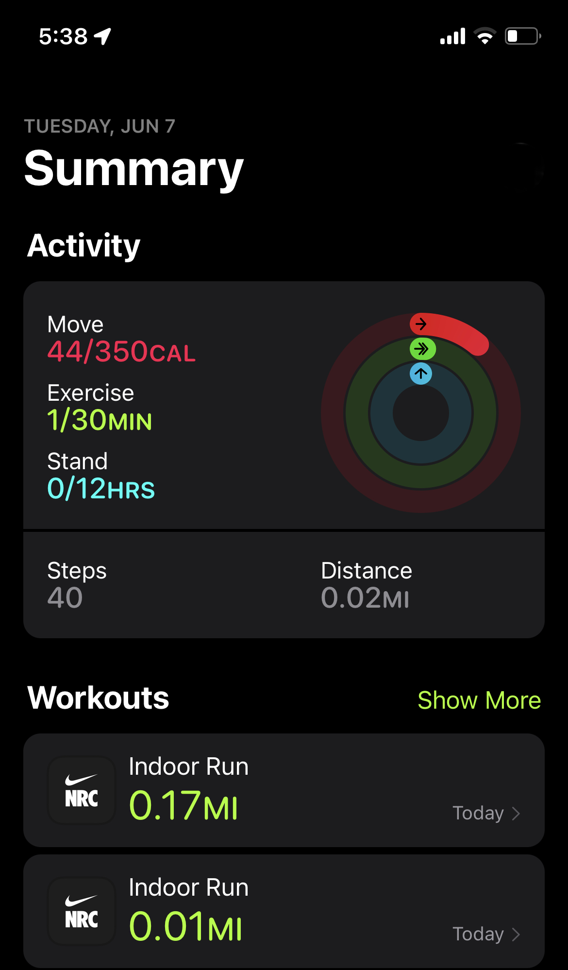

@Strutten So you’re saying your red ring is filling up?

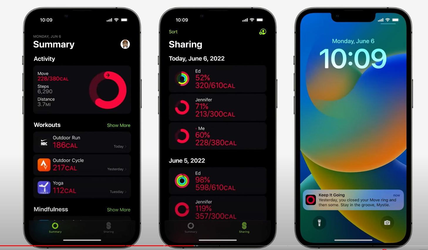

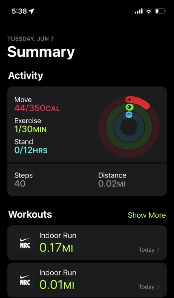

But does your setup have three rings like normal, ie the first photo;
Or does it look like what Apple showed as the new Fitness App Without iPhone, ie second screenshot where you only see the one Move ring, and then Steps and Distance below it where the other two rings are?

It's the second one. Just the red ring, and that uses information about exercises that it's received from Garmin (via RunGap and Health).

Same. I have a watch. I unpaired it and still was getting the three rings, and although the exercises I did in third party apps would show up in a list (below the rings) of Workouts, they wouldn’t count towards nor advance the red ring. What am I doing wrong here?

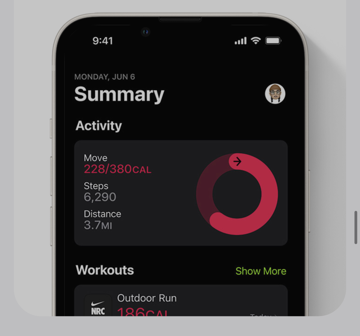

Apparently the Fitness on iPhone Without Watch app should look like this (screenshot from WWDC presentation)

The short of it is, if you want the Fitness app to show you only One Ring, i.e. the Move Ring, you need to make sure that no Apple Watches are associated with your iCloud account. This however is harder to do than one would imagine.
The problem is that you can't have any Apple Watches associated with your iCloud account. I had tested AWs before, but I don't currently have one. But my wife has one. But it's under her account. Or so I thought. She, and everyone else in the family have their own iCloud accounts, but are all logged in to my account for the AppStore. I've had it this way for a decade plus. Well, it turns out that when a device, like her watch, is logged into my AppStore account, it then shows up under my devices under iCloud. So the solution was to remove her watch from the list of "my" devices under iCloud (you can do this on phone or Mac, just click on your name in settings, and you'll see a list of all of "your" devices, which in my case is every device everyone in my family (kids, parents, etc) own).
This unfortunately creates another problem whereby, now her watch keeps asking for the password to my account bc it is trying to update the apps on itself, and the second you input that password, the watch gets re-added to my iCloud account. So the only solution is to log her out of my AppStore account on her phone, and log her into her account. And then share my app purchases via Family Sharing, which I do already have set up. But then, as I understand it, you either have to delete all the apps on her phone and redownload them under her account, otherwise, they will keep asking for my account password in order to update, and when you provide that password - catch 22 - the phone/watch gets re-added to my account.

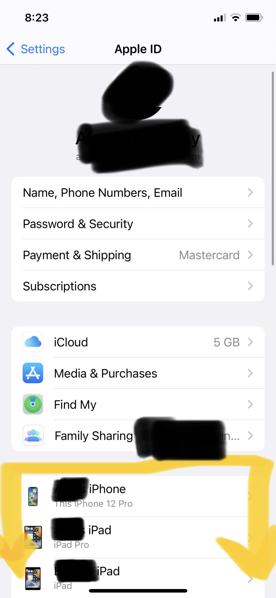

You might be right, but I have never had an AW or had one associated with my iCloud account. To me all rings existed when Fitness app was installed with the iOS 16 update.
Go to iPhone - Settings - Click on your name. Look at the list of devices associated with your account. Are there any Apple Watches?

Humor me, check in Settings, under your name (very top of settings), are there no watches listed there?

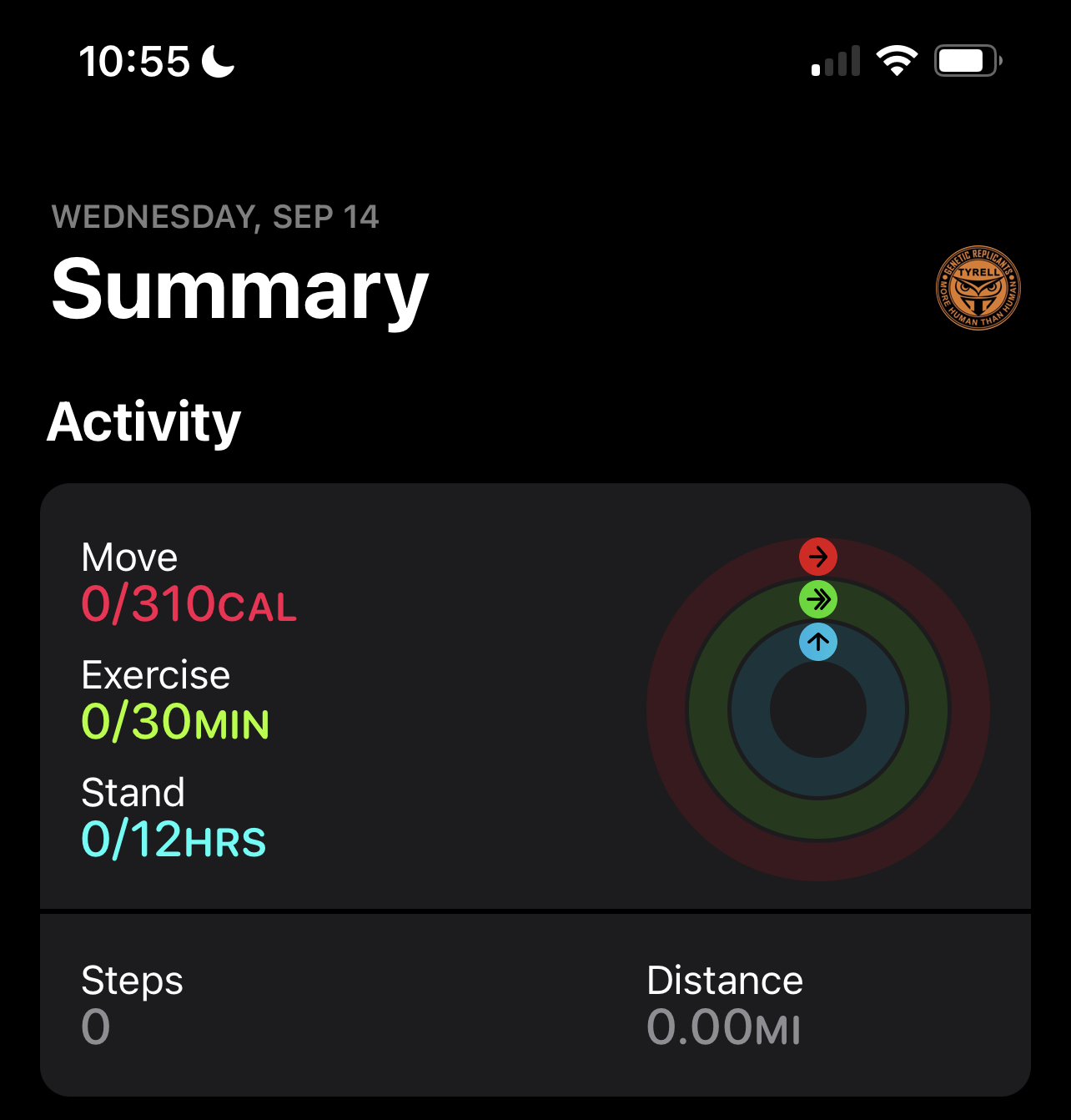

I have the same issue.I used to have a watch paired but no watch is currently paired with my phone or showing up under my Apple ID in the phone or on the icloud/Appleid website. The fitness app is still acting like it’s expecting to be used with a watch.
I’ve uninstalled the watch, fitness and health apps, restarted the phone and reinstalled fitness and health to no avail. Tried turning off health cloud sync and reinstalling fitness but I still have three activity rings. Health app tracks steps but the fitness app just seems broken. Funny thing is the rings are lit up like it’s connected to something, not darkened like it is when there’s nothing connected.

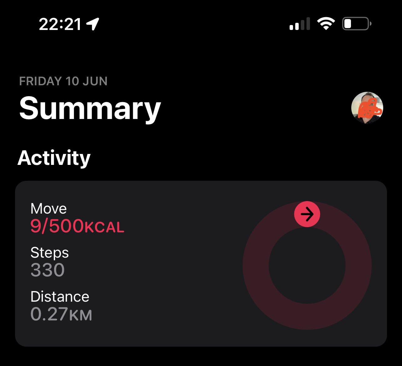

I don't currently have an Apple Watch, but I have a Garmin watch connected to my iPhone. The Fitness app only shows my "Move" ring, and it reads "Move" activity from both the iPhone and the Garmin watch. It doesn't look like a 1:1 match, but it's counting at least some steps on my phone in addition to what the watch is giving me. My watch says I've walked 7,771 steps today, the Fitness app shows 7,829 steps. Strangely enough, the Health app shows 7,881 steps, so it doesn't match with either of them.
