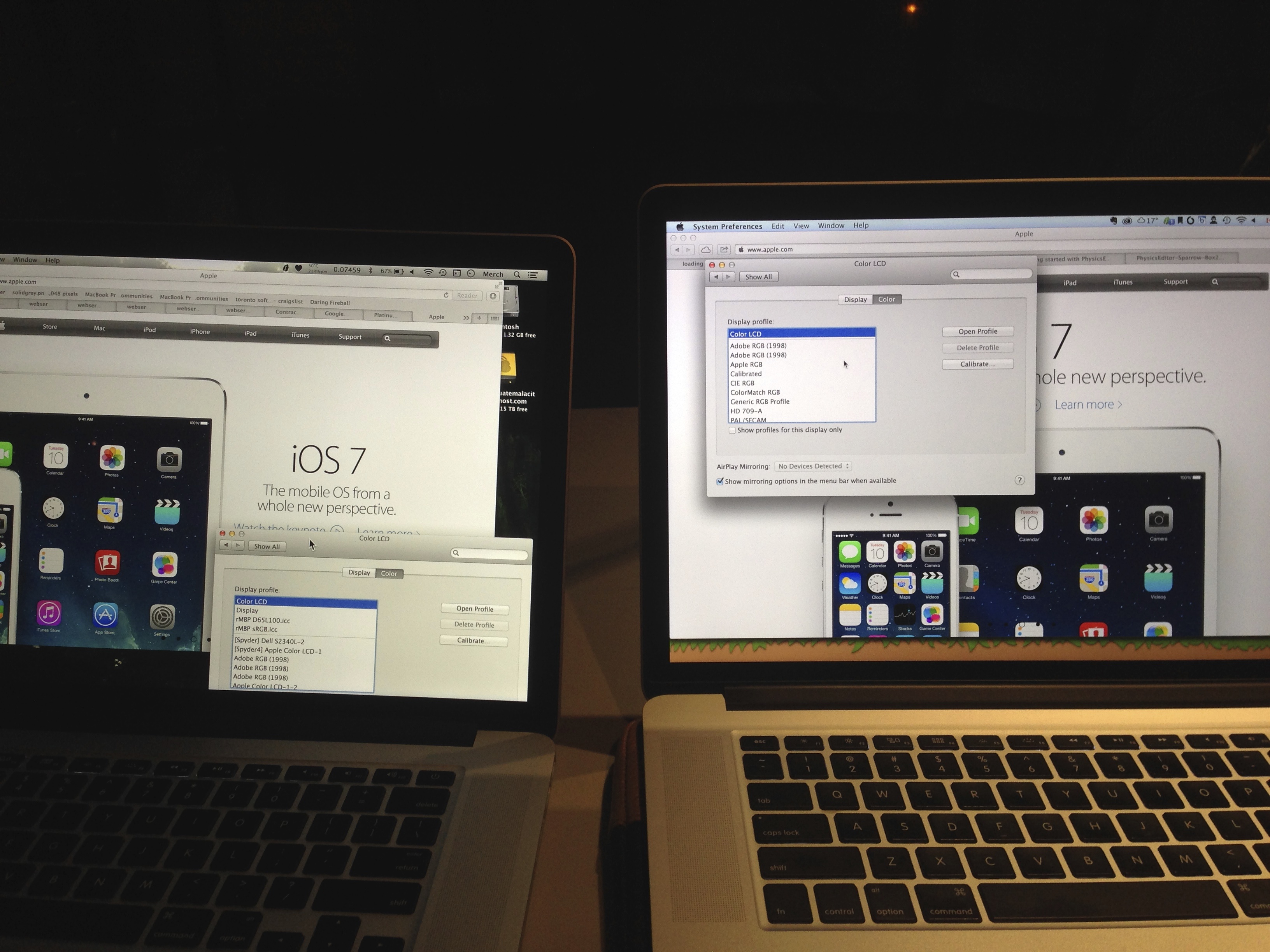

I got my display replaced and the replacement Samsung LSN154YL01001 is yellow tinted. I've been to the Genius Bar 3 times to complain about it and I will be going again soon.
Just calibrate the display to a different white point.
Schmanky, I know you have tried calibrating the display with a Spyder4Elite. What white point did you set during calibration, and what were the deviations reported after the calibration? If you went with default settings, your display is calibrated to ~6500K, which will seem warm compared to the default white point of many other displays (often ~9000K), and even some rMBP displays.
If you want to match the white point of another display, just use your Spyder4Elite to match the white points. The calibration wizard should even give you an option to measure the white point from another display, and then match to that. Or you can just set the target white point to 8000K or 9300K during the calibration, if you find 6500K to be too warm. Do the calibration on all your devices to the same white point.
I've tried the profile you posted in a previous thread, and it deviates only very slightly from my own current profile, with which my display reaches 6500K very accurately. It's not your "yellow" display that is faulty, it's the comparison that just has a different white point.
You've been posting about this issue since March, so let's try to get it fixed already.
