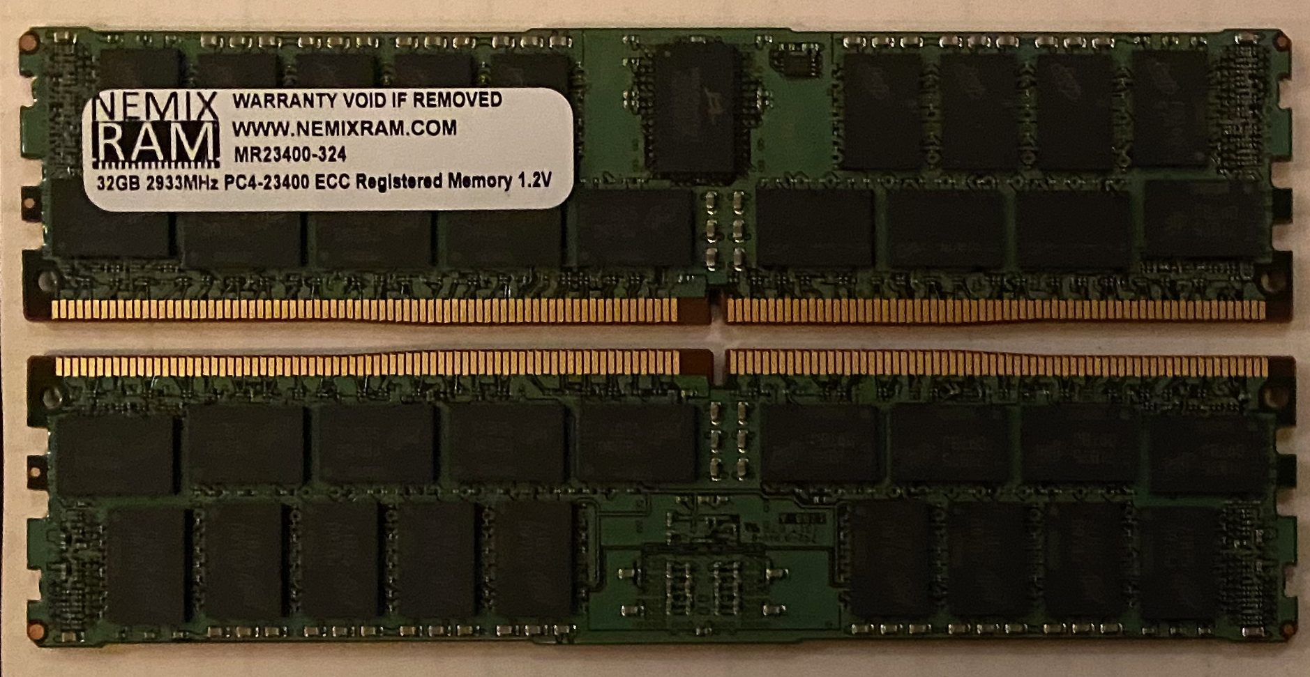

I have NEMIX (12x 32GB R-DIMMs) in my MP7,1 16-core and it's running fine without issues. I paid around $1,500 for the 384 GB of RAM early on in Jan 2020, just before prices started to rise everywhere because the vendors saw a chance to make more brass for themselves.
I'll take one of the R-DIMMs out and take images of front & back later on after completing my initial setups as I only received my MP7,1 yesterday.
It's currently under 'torture' testing using Prime95 and the RAM is being pounded on as well as every thing else. No hw/sw issues have arisen so far after running the 'torture' test for close to 24 hrs.
[EDIT] I found an earlier image of one of my NEMIX 32GB R-DIMMs.... see attached. It's not very detailed but it's all I have at this time.
I can't see the markings on the ICs . If you could take some clear , close ups of the DRAM chips and the register chip ( the one in the center on one side ) I would be able to be in a better position to judge the quality of the module .
