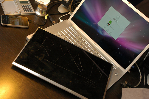

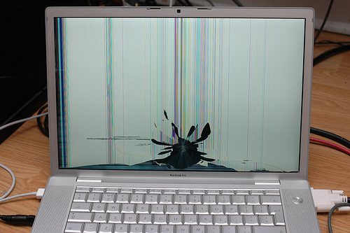

Here's some photos of the process. Nothing quite like saving $500 and exploring your own machine.
Before.

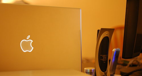

After.
The LCD panel itself quite something to hold by itself. It's amazingly thin, and beautiful to look at. I'm keeping the LED backlight for some possible future light table project.
