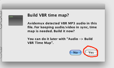

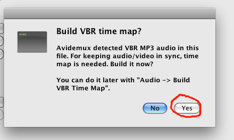

Say "yes" to "Build VBR time map?" if it pops up.

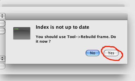

Say "yes" to "Index is not up to date - Rebuild frame" if it pops up.

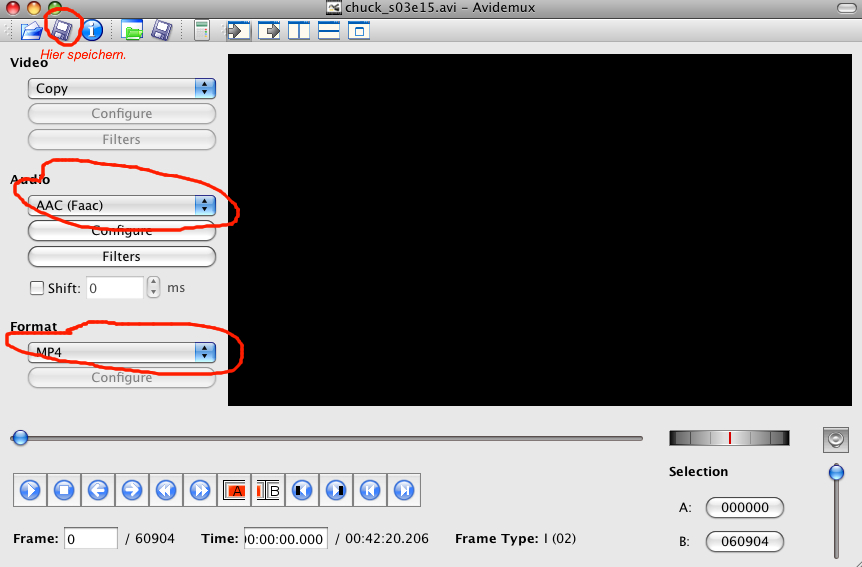

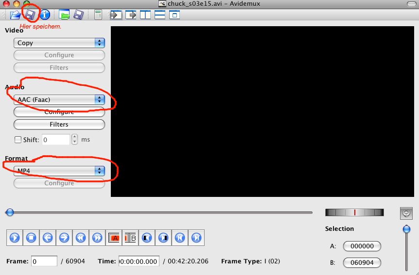

3. Set Audio to "AAC (Faac)".
4. Set Format to "MP4".
5. Save file with extension mp4.
