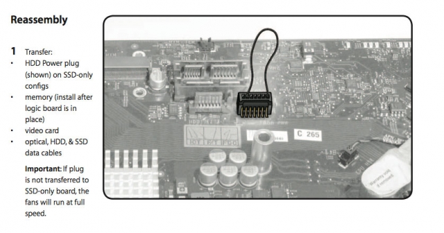

Seems Hardmac.com has figured it out:
http://www.hardmac.com/news/2011/05/14/it-is-currently-impossible-to-replace-the-hard-drive-of-the-2011-imac
Hardmac.com said:
It is the solution provided by Apple on the models coming with an SSD: short-circuit pins 2 and 7 on the power supply cable.
Here is also an explanation of the reasons that pushed Apple to introduce that system in the 2009 iMac. As we sais earlier, the iMac checks very often the temperature of the hard drive. If it was doing so with the SMART system, it would shrink the disk bandwidth and would freeze the disk for a very short time at every check.
Therefore Apple decided to do it with an Out of Bandwidth system, outside of the data channels of the disks. At first the company used connectors added to most hard drives and used for programming and testing the disk. That solution had one drawback as each manufacturer had its own connector. The 2011 model uses a new system. All the information now goes through pin 11 of the power supply connector, which is normally used to light-up a LED during disk activity. In prodder to change the use of that pin, a specific firmware was needed, which explains the reason that only disks sold by Apple in the iMac don't have any problem.
OWC has also posted a follow-up post, but it still doesn't address this discovery from Hardmac.com:
http://blog.macsales.com/10206-further-explained-apples-imac-2011-model-hard-drive-restrictions#more-10206

The fans will not go full speed BUT the hdd fan now will not react to HDD temperature increase as the mac now thinks is an SSD and doesn't need cooling.
I highly recommend keeping an eye on the temperature and install HDD Fan Control to be on the safe side.
At least they got that right. No moving parts = not as much heat generated by the SSD = no need to ramp up a fan to cool it.
This happens when you use a y-splitter SATA power cable and pin #11 gets grounded, effectively neutralising the thermal sensor as described above.
Didn't Hardmac say something about if you did that, the Mac would report the drive bay as empty, even though it is populated?
Yes, it says on post #78 I think. Not sure if it reports the bay empty since it clearly has and uses a drive in the bay but rather ignores the temperature signal and keeps the fan at low speed as it would do with a SSD.
