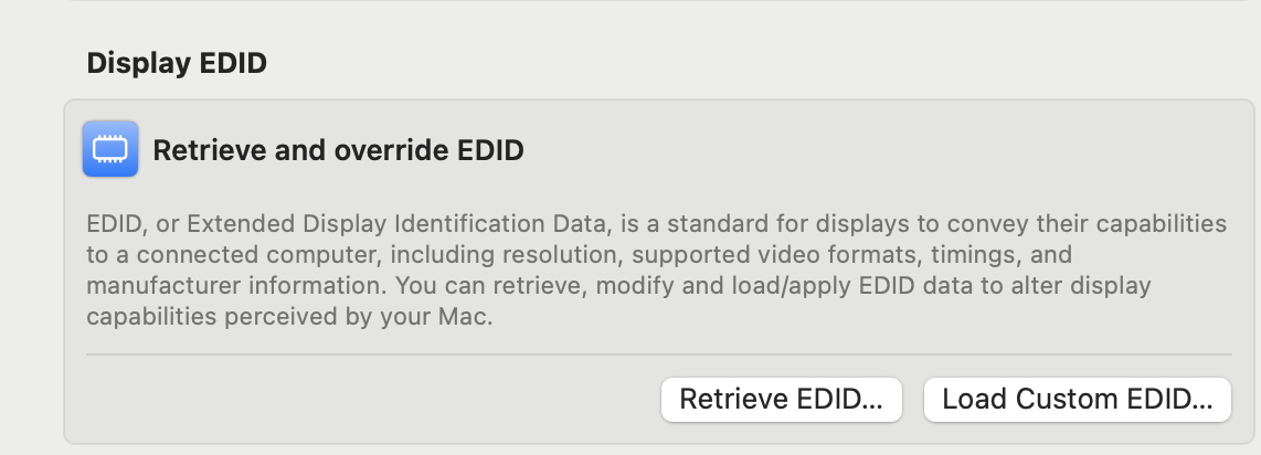

Check the EDIDs for build year and week? I believe the EDID for built in displays of iMacs or MacBook Pros has info about the panel being used.
Good idea, where would I find the EDID?
While I'm not sure how the EDID will help you, the easiest way would be to install Better Display. It can retrieve the EDID for you. I run the full version but the trial may be able to do it as well.

I've installed Better Display and both monitors show basically the same EDID information. Vendor, model ID, date of manufacture all the same.
