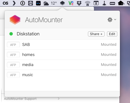

I was using a script for many years by a developer I found on some UNRAId forums that have since broken with Sierra, so I reached out to him on Twitter and to fix his own issue and to make it simple for others he has made a simple app called Automounter.
It has saved me having to constantly mess about with each OSX update.
https://itunes.apple.com/gb/app/automounter/id1160435653?mt=12

Hi guys - I'm the developer. FYI, I'm not using a script. It's developed in Swift, using low level Apple frameworks to mount your volumes, which is automatically integrated with your system keychain.
Thanks for your support everyone! Feedback is welcome.

Thank you for this! I've been trying to find what's happening with my Automator scripts since I've upgraded to macOS Sierra. I found your post today, purchased AutoMounter and got my problems solved! I have no idea why Apple made life more complicated for us. Is it for security reasons in this case? What security reasons? I can mount all my network drives as before but now I have to press Connect button. What kind of security is that? Come on Apple!
I even modified my Automator scripts so I had one script which mounts my network drives, this script is activated from a different script which waits 10 seconds and... presses the Enter key to accept connection. Crazy. But with this piece of software I don't have to worry about modifying my script to adjust them to multiple Macs on my network.
The author must have found a method to mount network/shared drives differently because they're not showing in the /Volumes folder. But I'm happy it just works.

Hi speedingant and thanks for the app. It saved my day. I previously used DriveMounter, but it too suffered from the problem.
I'll recommend your app to my friends for sure.
A short description page or FAQ page would be great. Although the app was very easy to use and I didn't need any instructions, there might be people who do.
The great thing is that it automatically re-mounts if it detects the drives have been unmounted. This is great for me, since I move around with my MPB a lot and it would be tedious to have to reboot or manually mount every time I get home and need to mount my NAS.
Can you tell me what the app does while I'm away from my home network? Does it keep scanning for my network drives or does it "give up" after it notices I'm disconnected from my (wired) LAN?
I'll work on a quick FAQ. I'm currently building in server discovery to aid configuration, which will be in the next release.
AutoMounter will poll every so often to check each servers service availability in the most efficient way possible (uses very little energy). It will not try and mount any volumes until it knows that the associated service is available. I also rely on the OS detection of any network change to trigger a check on your services to ensure a quick re-mount once your server is available.

Just bought this little app. Very very usefull. I guess I could have done the same with a shell script, some Applescript magic and messing around with login items, but this is much nicer.
Indeed the story is Apple doesn't allow to mount drives in /Volume anymore w/o root access. Using the mount_smbfs command you can mount to e.g. /etc. This what I hate about Apple and OSX. Just keep on making non-trivial changes nobody needs.
Thanks for the 1.1 update to AutoMounter, speedingant. Very nice. And a good help page as well. Kudos.
AutoMounter 1.2 being reviewed now, should be in your hands within next two days. Includes the ability to match a server with a WiFi access point name (SSID), send WOL packet to a server when the network changes, UI enhancements, Enhanced device discovery, and bug fixes.
