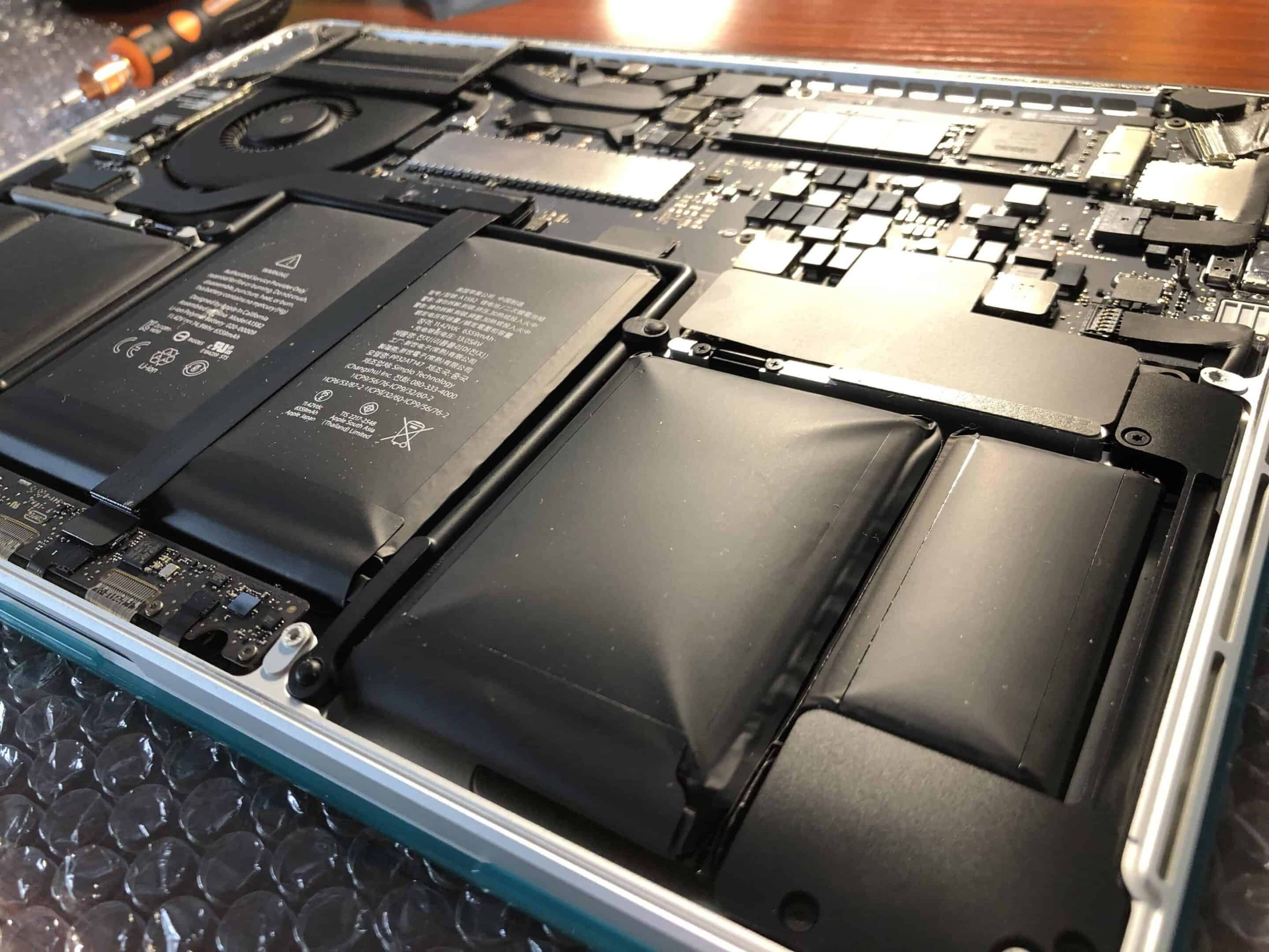

As my signature shows, my computer is a MacBook Pro from 2017. It still works fine for my needs, though just a few days ago I discovered that its battery has swelling issues. It swells when it's charging, but once it has stopped charging it de-swells. This is not the original battery, but is rather the replacement which I think I had Apple install several years ago. I will use this laptop as long as I can, though I have no intentions of replacing the battery at this point since the money spent to replace the battery is better spent towards buying a new one.
Anyhow, this has made me wonder if Mac laptop battery technology has made significant improvements since 2017. I intend to replace my laptop with something like a MacBook Air, although when that would be would really depend on the swollen battery. Have they even solved the problem of swollen lithium-ion batteries? Quite annoying to have a swollen battery though. At its current state, it slightly impedes the trackpad button.
If your battery is showing any signs of swelling you should get it replaced or stop using it completely.
They can rupture, explode and catch on fire.
Yeah, that's what I thought, too. However, over a year ago when my spouse's laptop did the same thing with even more swelling (and it's an older model), we took it to the Apple store for an assessment and they said it's fine and to keep using it. I was a bit surprised too at the advice.
How they know battery swelling unless they look and battery visibly swollen? Battery that has swollen and impeding hardware functionality definitely should be replaced.
I, too, recommend against using a laptop with a battery that swells up.
I have no insider knowledge, but I reckon that since 2017 battery tech has improved for ALL laptops, not just Macs.
If you don't want to get the battery replaced again, might be time to start shopping for a replacement. You can save some money by going Apple refurbished, if they are available where you are...
To answer your question...there has been no widespread battery swelling, so I'm not sure what you mean by improving battery technology.
The laptops you have seem to be flawed in some way.
