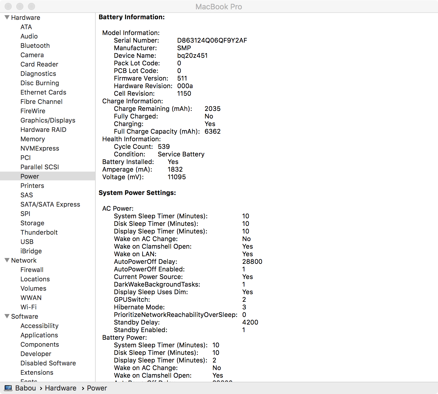

My 2013 retina macbook pro has thrown the "service battery" warning. What's weird is the battery cycle count does seem to be all that high. Only 539 cycles and 75% capacity remaining?
Cycle count is only one dimension of battery health. The others are heat and state of charge. For example, if you leave a MacBook plugged in all the time, it will degrade the battery.
There is a safety aspect to this as well. Once the battery starts bulging, it may rupture because the safety margin of space is gone and something can easily bump the machine. If it does, you will have a catastrophe on your hands as it can ignite and burn at very high temperatures. This is not too likely, but excerise caution.
Apple had a free extended battery replacement program for retina macbook pros for machines just up to and not including the late 2013 models. I think it has ended, but you can look it up and ask if you can still get some level of service. I doubt it as well.
539 cycles is quite short, especially if you have used your machine as a desktop most of the time.
Batteries degrade with age, regardless of use. Some degrade quicker then others. Its absolutely normal that you battery has to be replaced after 4-5 years of use.

I believe it's the "capacity remaining" that triggers the alert (not the number of cycles).
