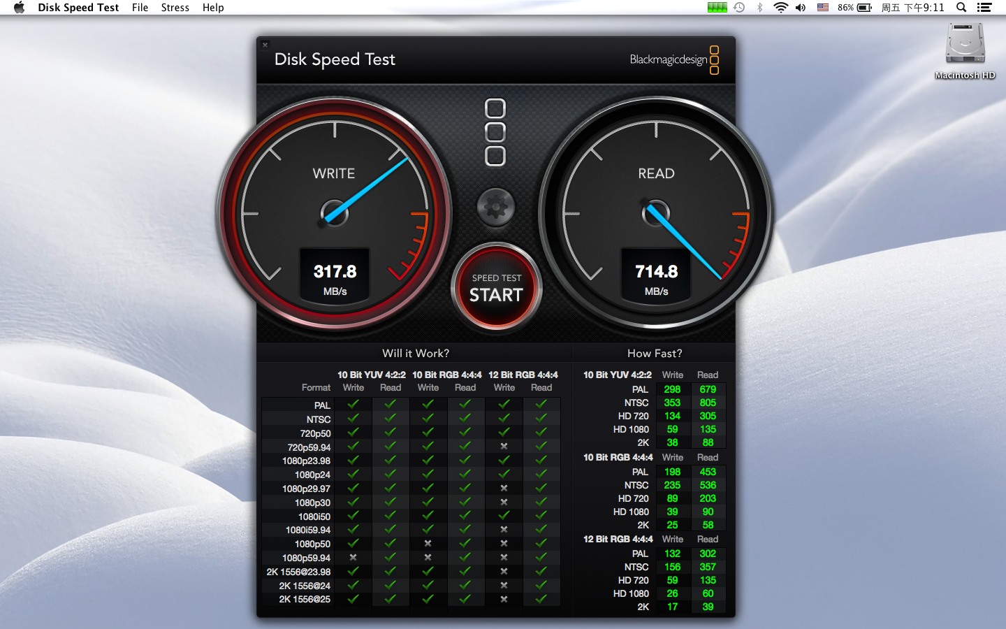

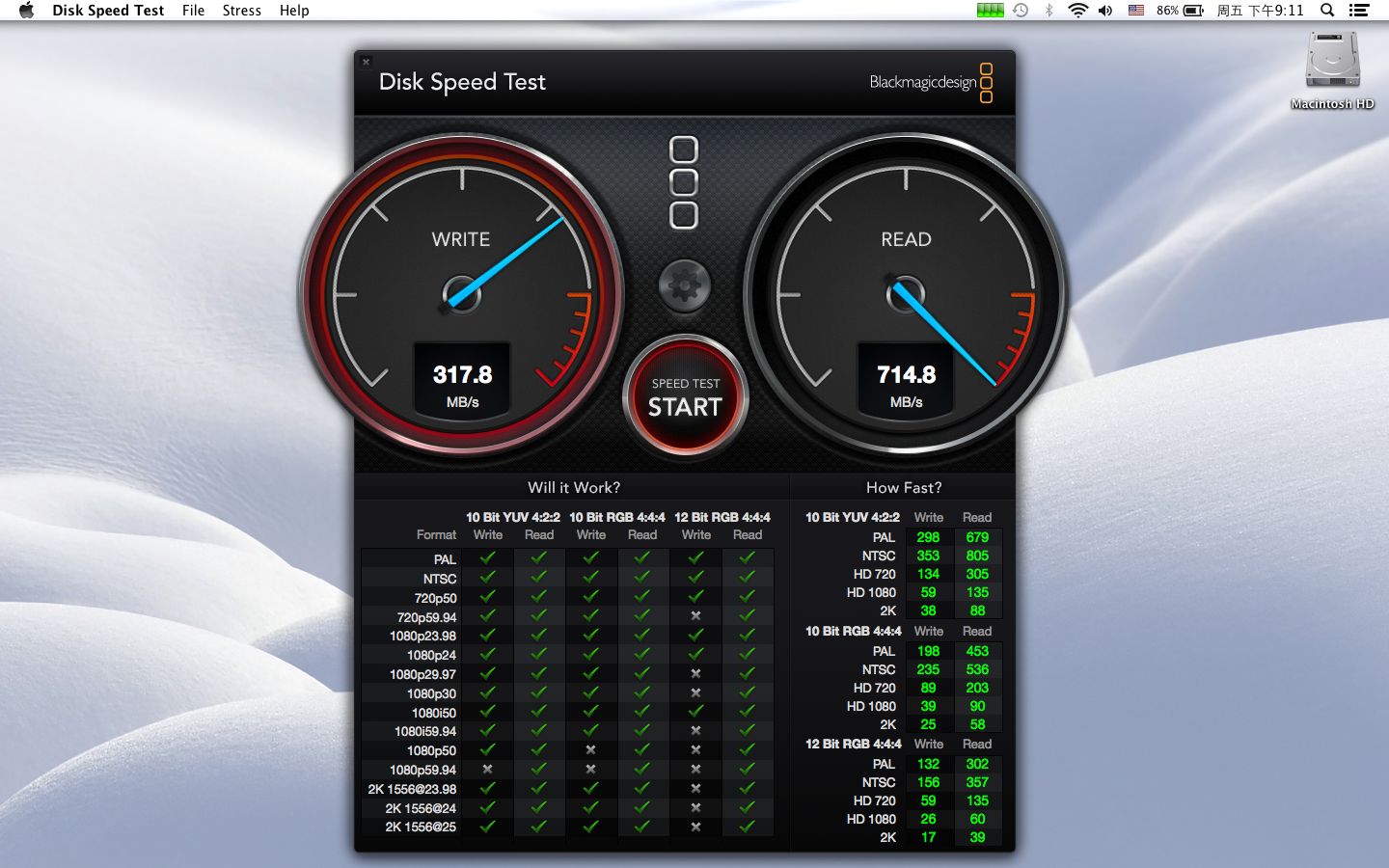

Hi everyone, I just got my brand new mid-2013 13-inch Macbook air today, but when I test my disk speed with Blackmagic from the App store, it gives me a very low written speed(other people are showing around 700MB/S write?).
Is this something that I can take my machine to the Apple store and demand a switch?
Thanks for help!

You can always try, but you will hardly notice a difference between the 300 to 700 MB/s write speeds in normal daily usage, unless your normal daily usage depends on writing dozens of GBs to your SSD on a daily basis from a source, that offers those 700 MB/s or 500 MB/s.
You could also try XBench and AJA System Test to see, if they show you the same results.

Thanks for the advice. I know I wouldn't notice the difference there, but it kind of makes me uncomfortable because one of the major features of the 2013 MBA is the big improvement of the disk speed. The speed that I have now is kind of the same as 2012 model.
I will try the software out and post the result.
The result is the same. 🙁
317MB/s is a 'very low' write speed? LOL
Your results are comparable with what others are getting in benchmarks using the 128GB drive
http://blog.macsales.com/19008-performance-testing-not-all-2013-macbook-air-ssds-are-the-same
It is a low speed compare to 700mb/s. On WWDC, Apple mentioned clearly the ssd has a 40% performance increase than the previous version, but now I don't see that major increase.
Are you suggesting that all 128GB SSDs have the same 300MB-ish write speed?

Yes it is a very fast speed but this is not a impressive PCIe based SSD performance. I agree with you that I should enjoy my Mac, but it kind of bothers me having the idea that I might have a problem SSD.

Go back, return it and pay 200$ extra for the 256gb ssd and you will get 700mb/s write speed...
The 128 ssd gets around 300 like yours. The 256, and 512 get closer to 700. This is because they have more cells in the ssd resulting in better efficiency and then speed.
The 40% was probably on the read speeds. As far as I knew, only the 256/512gb models were hitting the 700mb/s+ write speeds. The comments section in the link posted above gives a pretty good explanation as to why its faster on the higher capacity models.

Ok, if all 128ssds have the same performance, I am ok with the current speed. I just thought that all ssds have the identical speed.
Thanks, that helps.
I get it. Thanks for the comment.
2013 MBA 128GB owner here and I can confirm your speed is normal. The higher speeds you see reported by others are the 256GB models. This is common with all SSDs.
No they don't, just like not all hard drives have the same speeds. The 128GB SSD, aside from using a different vendor and different controller, has a different NAND density than the larger 256GB and 512GB models. This affects write speeds, but as you've seen, read speeds are unaffected.
In real world usage, you're probably not going to see a disadvantage from this at all unless you're doing things that involve constantly writing massive amounts of data to the SSD. And constantly writing new data to an SSD is the surest way to kill it, so if that's your use-case, you definitely need to rethink your purchase or consider getting an external, conventional hard drive.
Just take comfort in the fact that A. All 128GB SSDs on the 2013 Mac Air do this, and B. If running performance tests is all the work you have for your MacBook Air, then it's already a non issue really. 🙂
