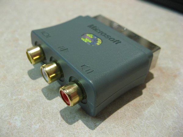

I read that it's possible to record via using the SCART input on the TV, uisng an adapter. I have this one adapter. My question here is wether I have to buy another composite cable, connect them in the composite in on the Hauppauge(where my Xbox component cables are currently connected), and then plug in the red, white and yellow to the adapter. OR, should I buy A/V cables, that I plug in to the front of the Hauppauge?
