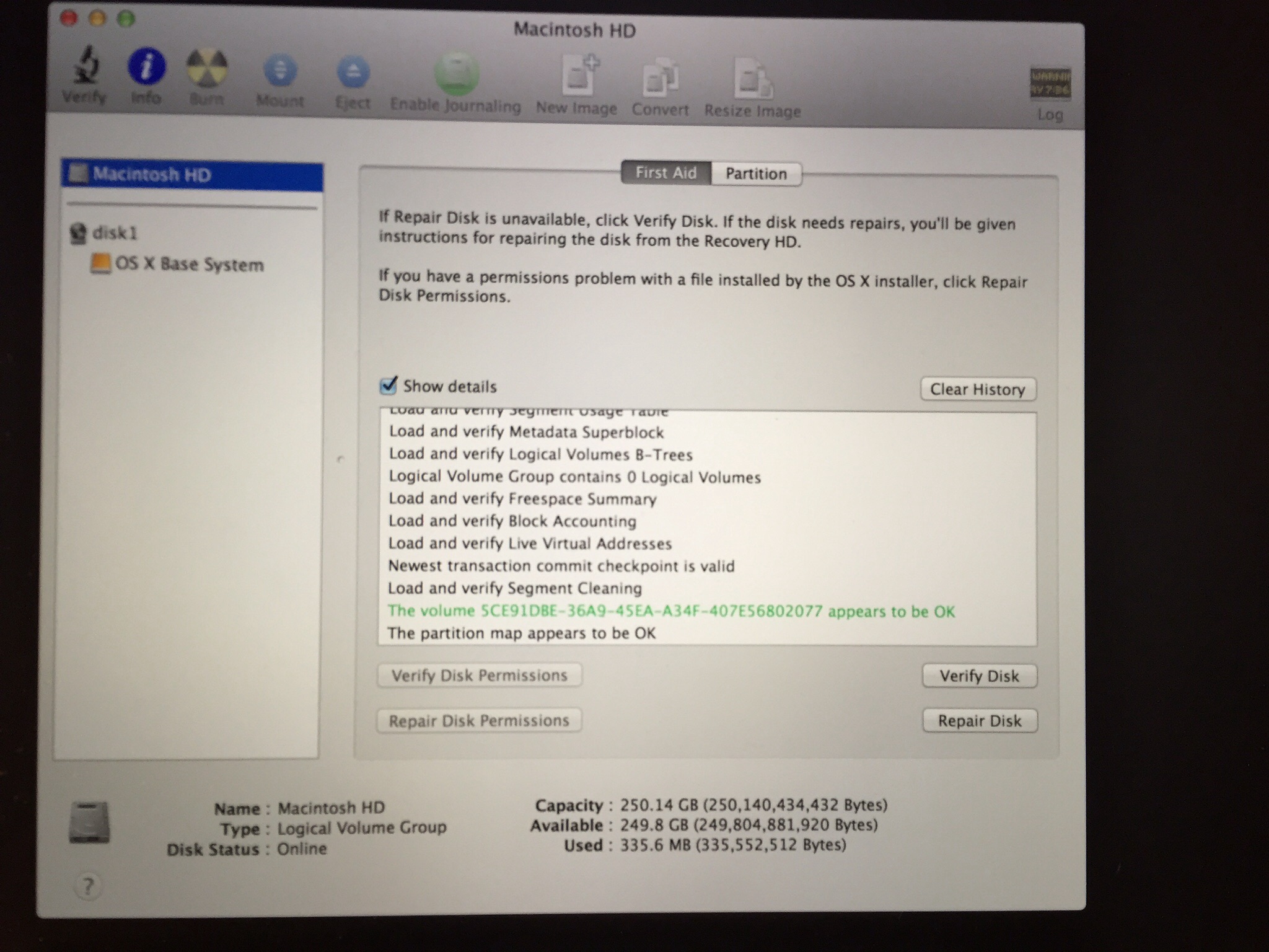

Yosemite FileVault was sucking my battery and I couldn't turn it off. So I booted into recovery and selected reinstall OSX. It failed and now I can't do anything. There is no way to select the Mac HD when trying again and there is no erase tab in disk utility. Please see attached image.
I was chatting online to Apple for 2 hours last night and he basically said take it to the Apple Store. This is super inconvenient and I can't get an appointment for over a week.
Is there anything else I can do to fix this?
Help.
I think I've done a similar thing.

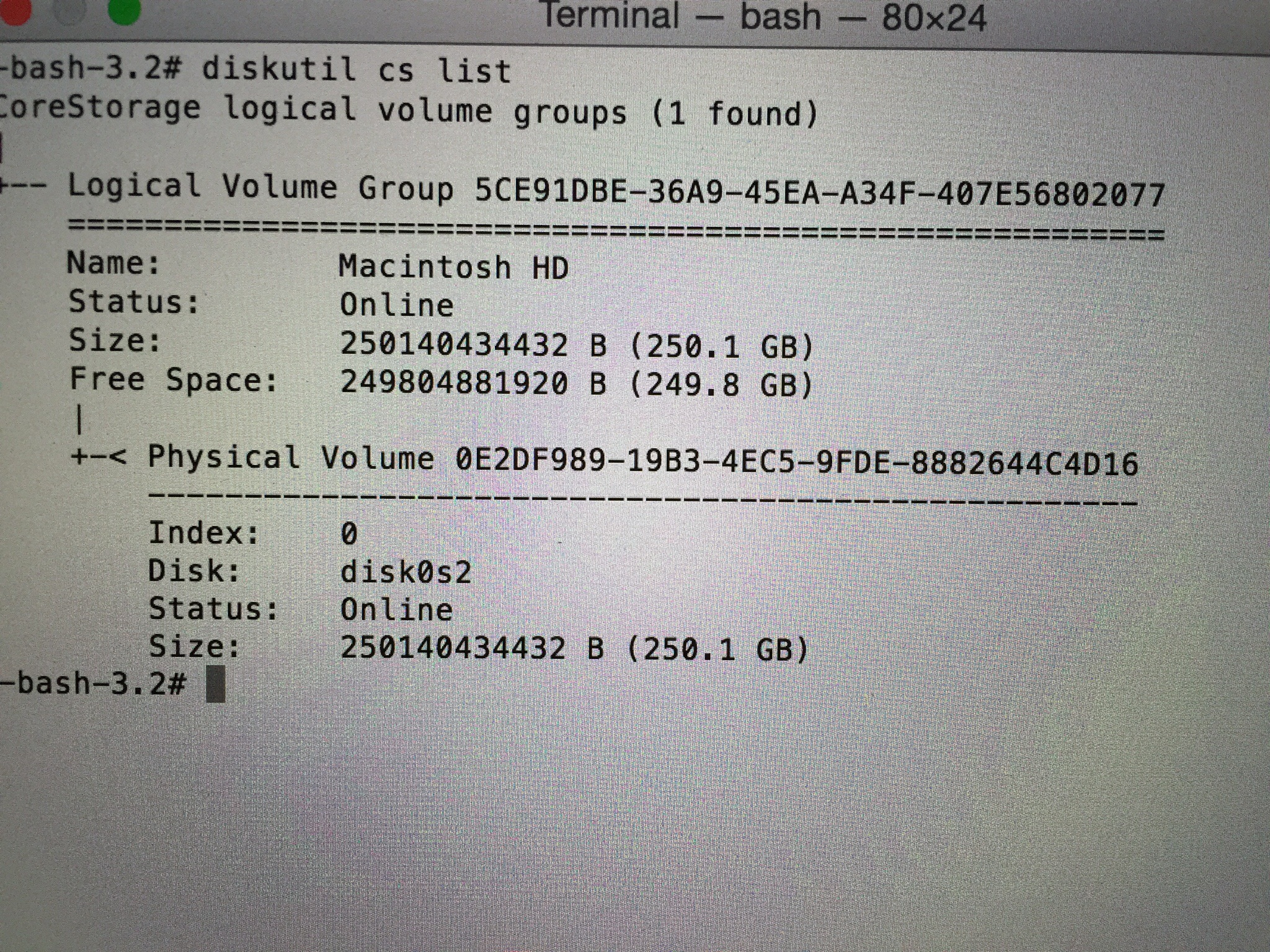

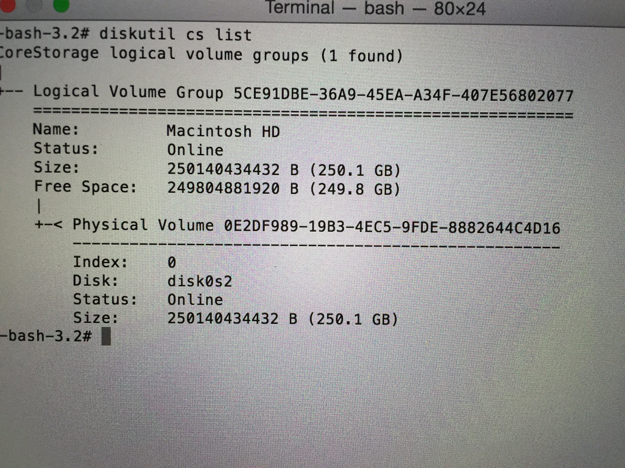

That screenshot is from recovery yes?
In the Utilities menu launch Terminal and run the command below and tell me exactly what it says.
Code:
diskutil cs list
I don't understand.
I can only choose disk utility, reinstall OSX, restore from Time Machine.
What do I do?
While in that same screen look at the very top along the menu bar and you will see Utilities. Click that and from there select Terminal then run the command I gave you and tell me what it says. You can just take another phot of it like you did earlier rather than write down the output of the command.
This is it.
Very good... okay here is what you do.
In that same Terminal window type in the command below and hit enter and that should kill the Macintosh HD logical volume group on there, then you should be able to format normally.
Code:
diskutil cs delete 5CE91DBE-36A9-45EA-A34F-407E56802077

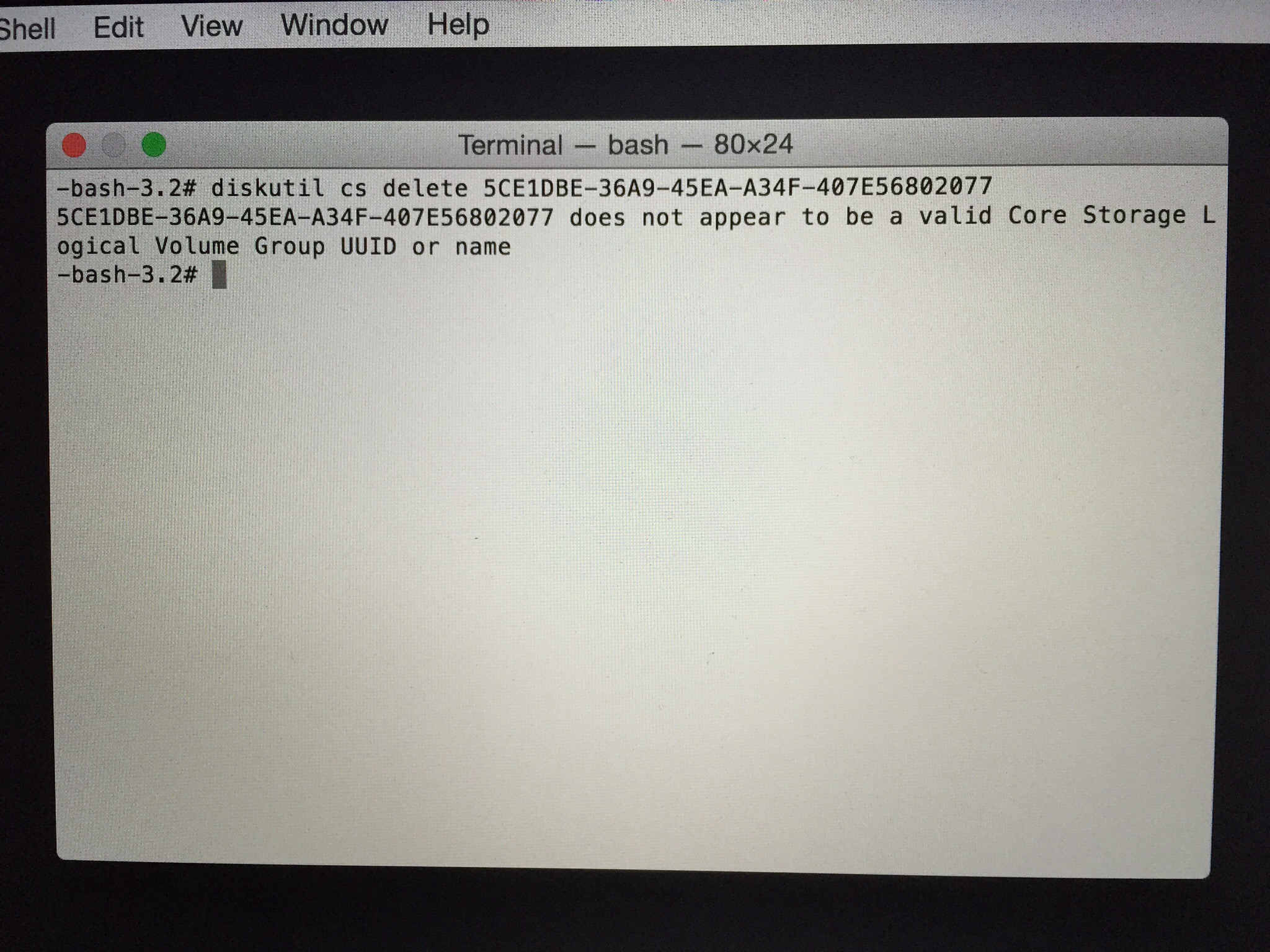

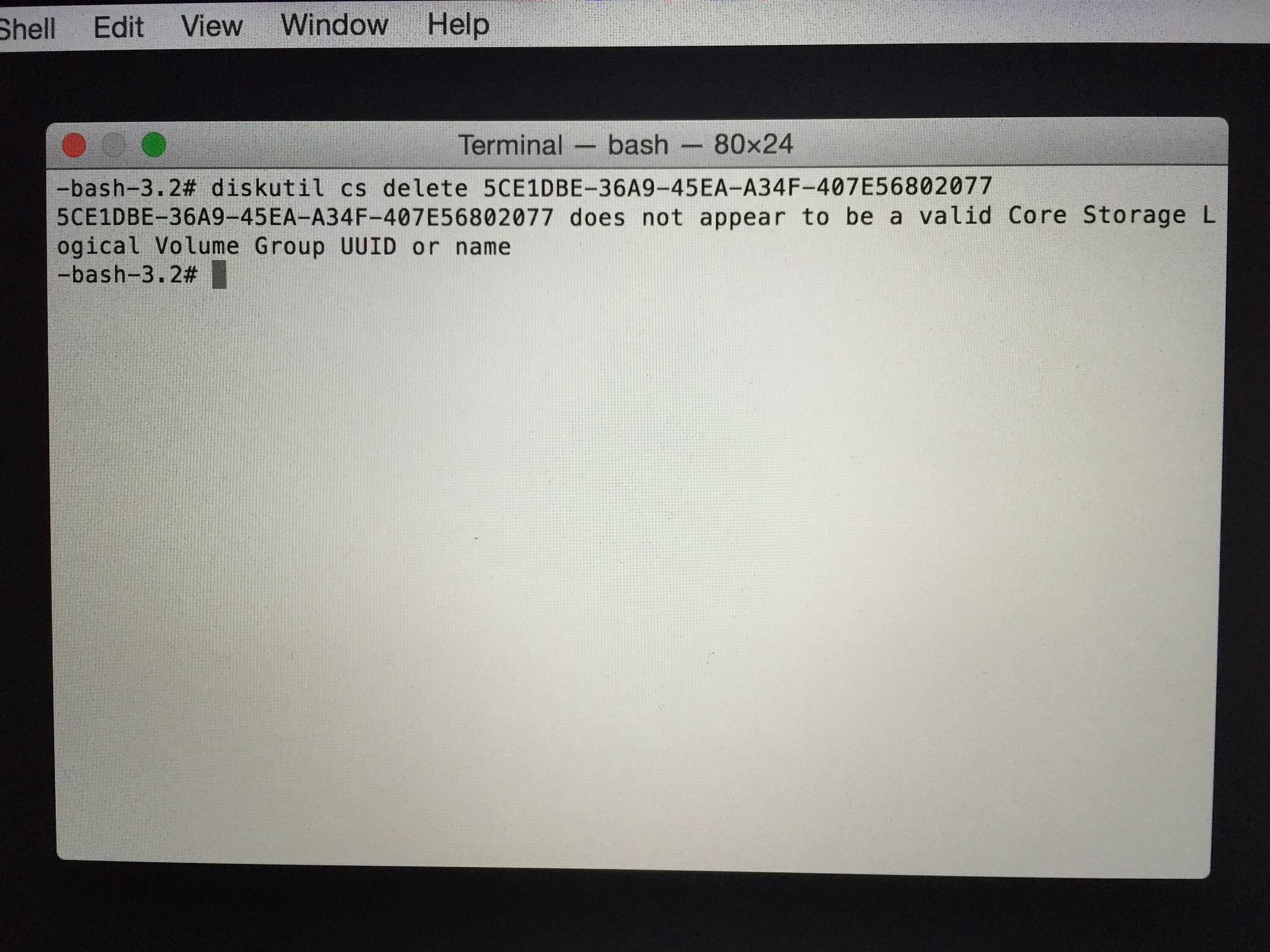

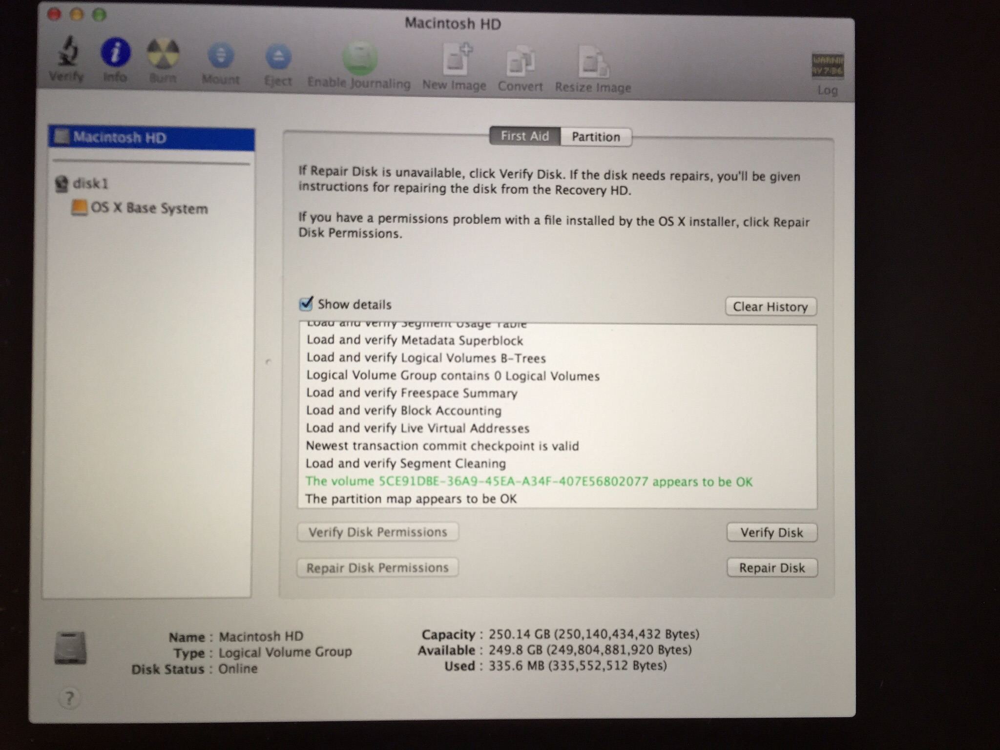

Oh my god, it worked!!!
I had typed it in wrong before.
Please, please, what do I do now? Step by step please as I'm a noob to this.
I have a time machine back up on my external HD if that helps.

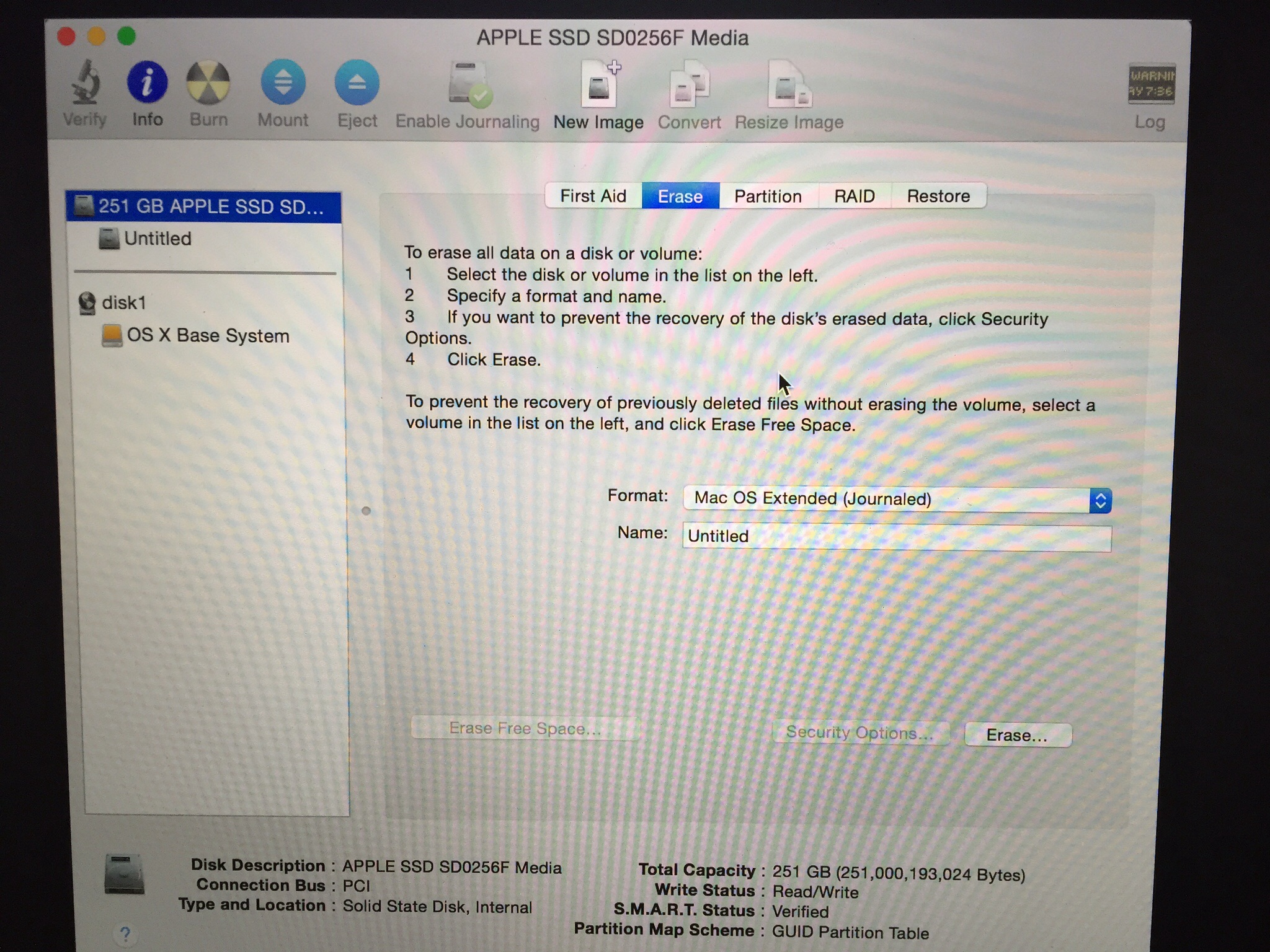

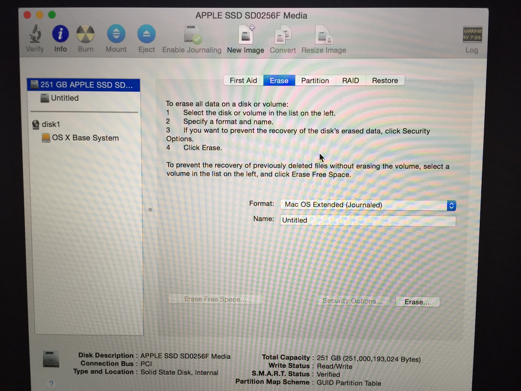

This is my screen.
Nice work! 😀
Okay. We are almost there. Go back to Disk Util and set it up exactly like you have it in your screenshot with the disk itself selected at the very top and Mac OS Extended (Journaled) selected in that drop down, then click erase at the lower right there. That will format the entire disk.
Now quit Disk Util and attach your Time Machine disk then click restore from Time Machine backup back at that main recovery screen and follow the prompts to restore. That will get you back to where you were as of the last backup and back in business.
