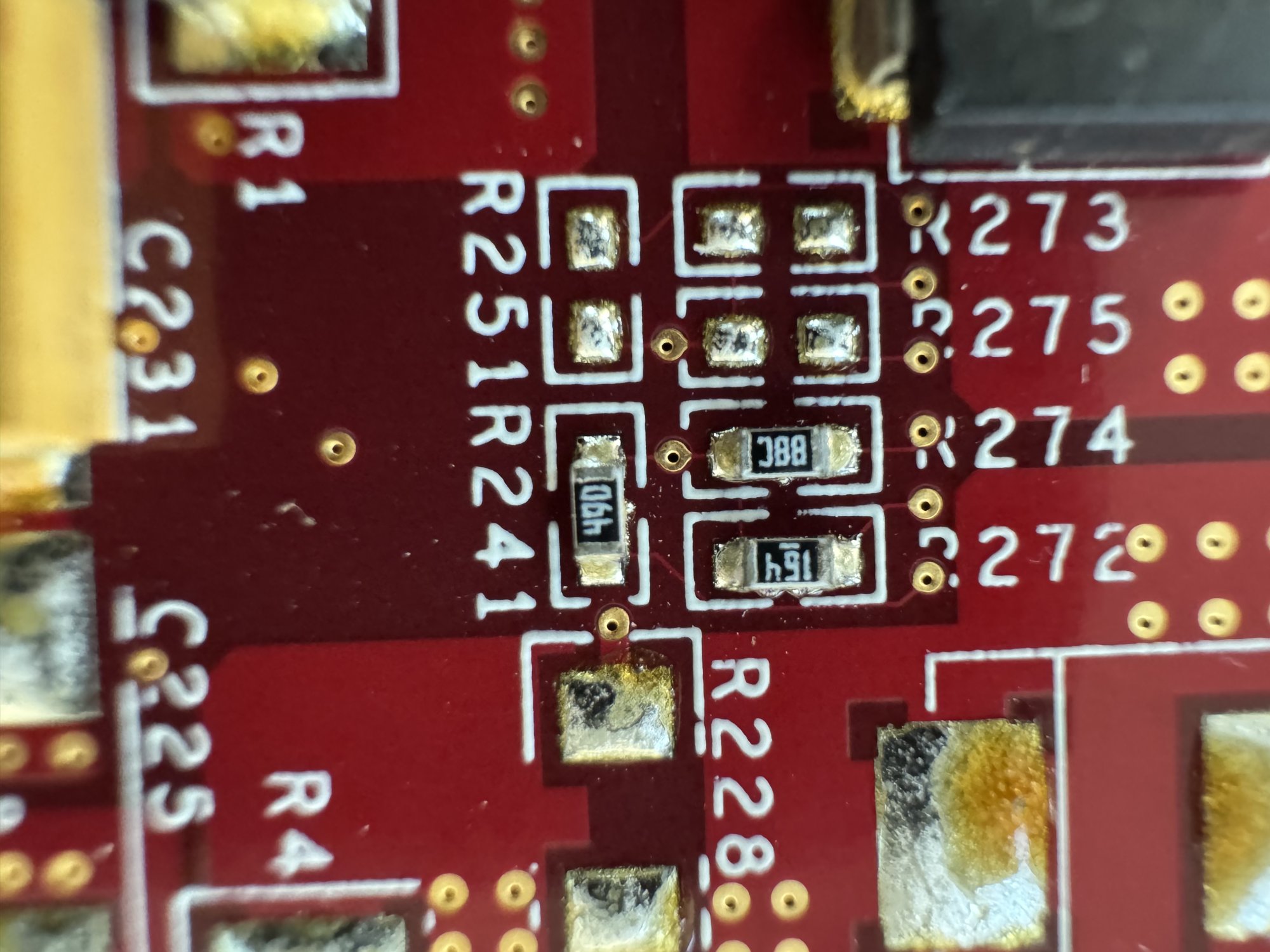

Also, if you happened to take any good pictures of the back side of the CPU card, I could probably work out what the voltages would be from the labels on the resistors.
Sadly i don't have some at the moment. But i have to strip the mainboard again anyway. So i can make some pics at least of the card's backside. Think i will let the heatspreader in place this time.

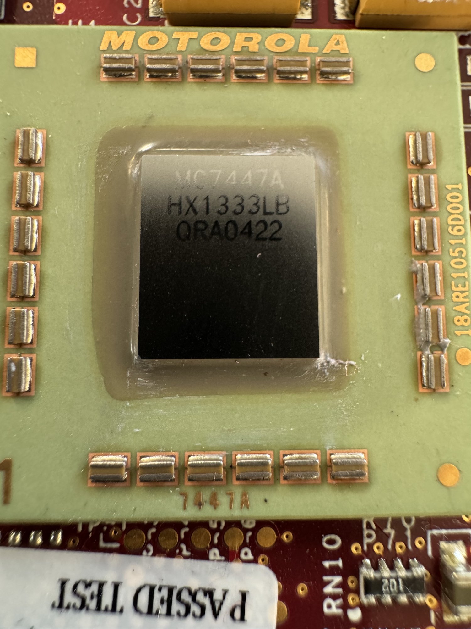

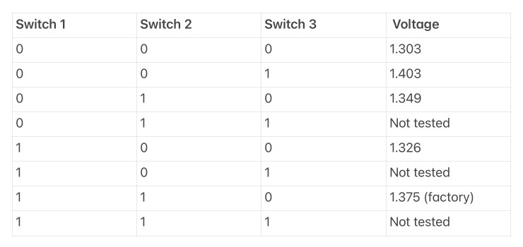

For what it’s worth, here are the voltages per some of the SW3 combinations, that I’ve measured for my card. Also, a close up of the resistors on the reverse of the card, which are suggested in a post above to be those used by SW3. Finally, a close up of the 7447a.
It is of the same design as the initial photos in the thread. It is the single 7447a version.
Apologies that it is incomplete. Once I reached 1.4 I stopped as that’s the max voltage I’ll need if I do go ahead with a planned 7448 retrofit to this card.
I was already super anxious about having a wire loosely connected to the inaccessible side of a cap under the heat sink, so that was a good excuse to stop!

My card is a single 1.6GHz 7447a which won’t budge at all with any overclock. The chip itself is marked 1.33GHz.
