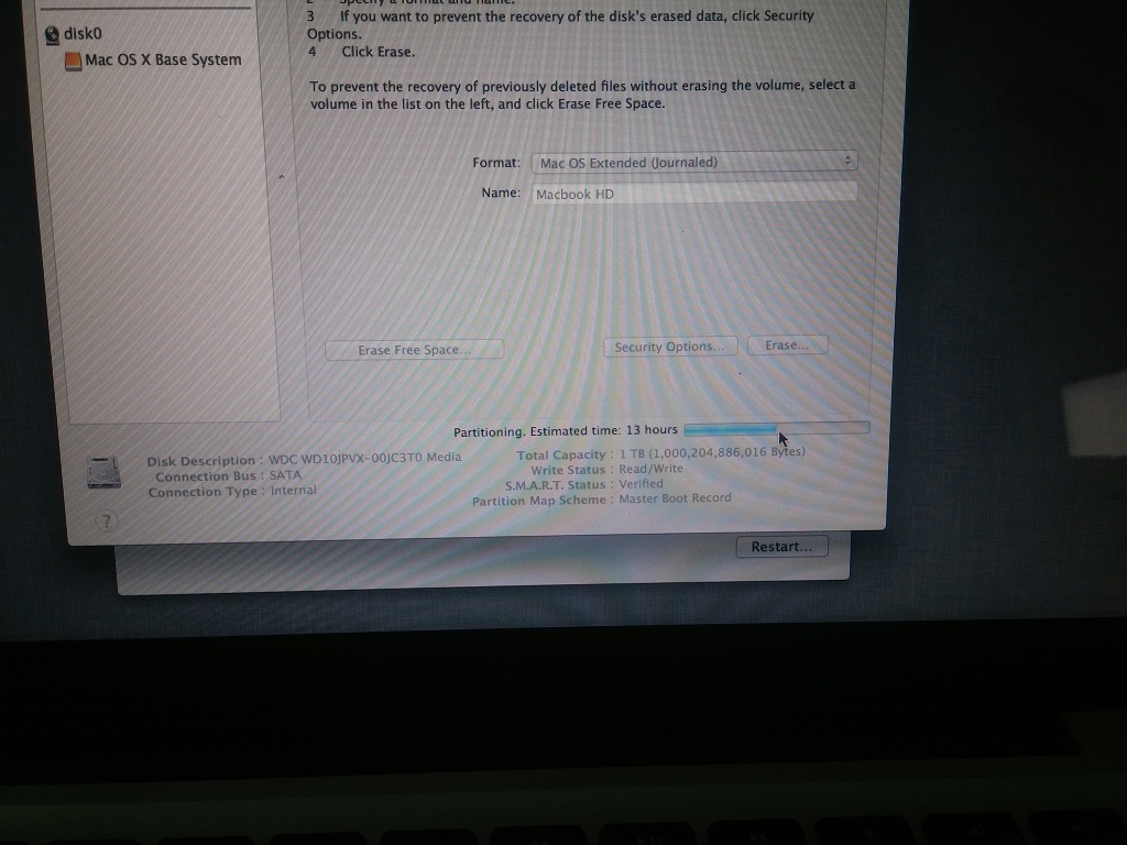

Hi,
I have Mid 2012 MBP,
I replace the HDD with WD Blue 1TB 2.5 HDD,
When I hear start sound I click on ALT, then I get the WIFI window, I put my password then click on "internet recovery", when it's up I choose "Disk Utility", then "Erase" and make new name "Macbook HD", but the create parition takes very long long time, what's the problem ?

The first problem I see there is you have the drive formatted to the Master Boot Record (MBR) format and it needs to be set to GUID. Follow this to reformat to GUID.
MBR would cause the OS to not boot properly, but it should still format the drive.
What caused you to install a new hard drive? Were you having what you thought were disk issues with the old drive? It is very common for the drive cable to go bad in this model and that can cause a good disk to appear bad and also cause the issue you are seeing.
Do you have an external USB enclosure you can put the new drive in to see if it can be formatted there from recovery? That would eliminate the cable from the picture.

I bought new HDD because when I try to boot the MacOSX I got blink question mark,
Now the HDD works at my Windows computer and I re-format it, but I install the WD Blue HDD and it's also blink question mark, but the Disk utility recognize the HDD (WD Blue).

If the drive is recognized on your PC, but not on the Mac, it may be that the drive cable is bad. Did you try to reformat the drive to the GUID format I mentioned.
Again, the "original" HDD (Hitachi 500GB) not recongized at MBP but at my PC is , but the WD Blue is recongize at MBP, and now I try the GUI.
