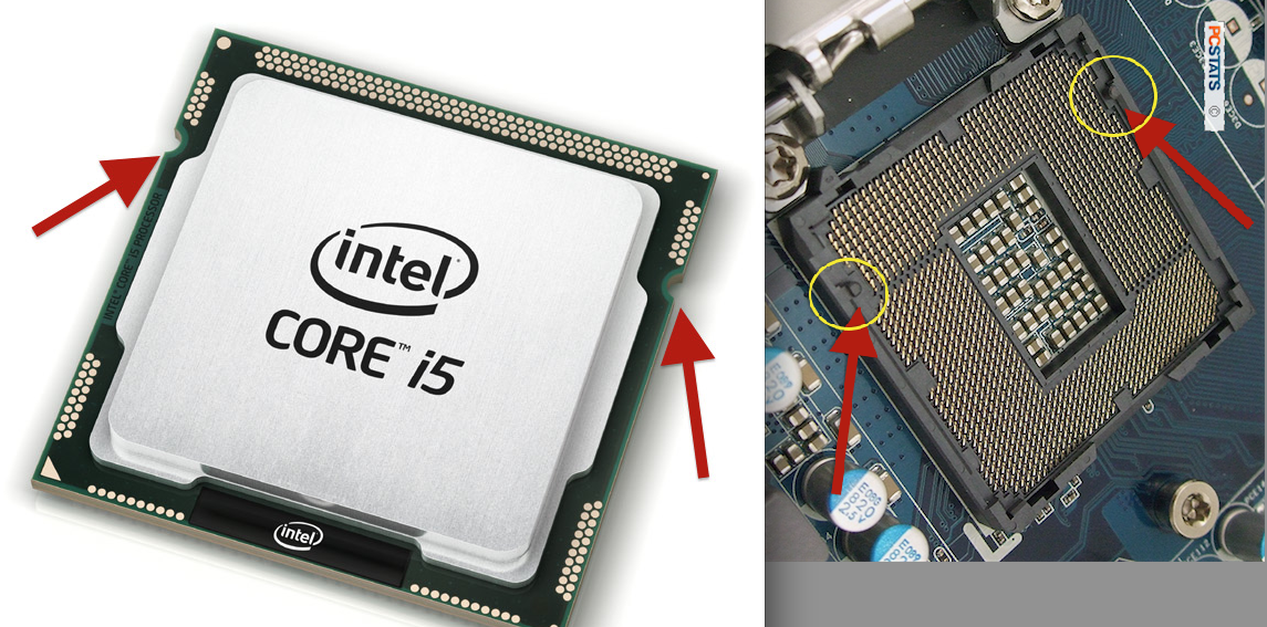

The CPU is also very straight forward as it and the motherboard are keyed for each other so it will only go in one way.
