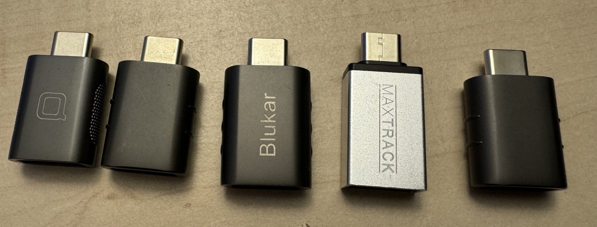

I also tried adapters from 5 different brands - all cause the same problem.

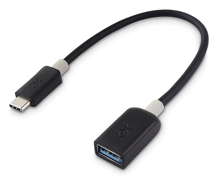

What kind of USBc-to-USBa adapter are you using?
Could you give us some actual examples?
Are we talking cable adapters like this:
Or... something else?
I'm thinking an adapter like the one pictured above is "dumb" (i.e., no electronics inside, just a physical "swap" of connections), but I could be wrong. Wondering how that could affect things?

In the end, this problem was unsolvable.
I tried various different enclosures with Intels JHL series controllers. All of them exhibit the same problem as long as an empty USB-C adapter is plugged in.
My workaround was buying a different enclosure, one with an ASMedia ASM2464PD controller (for example ZikeDrive Z666).
