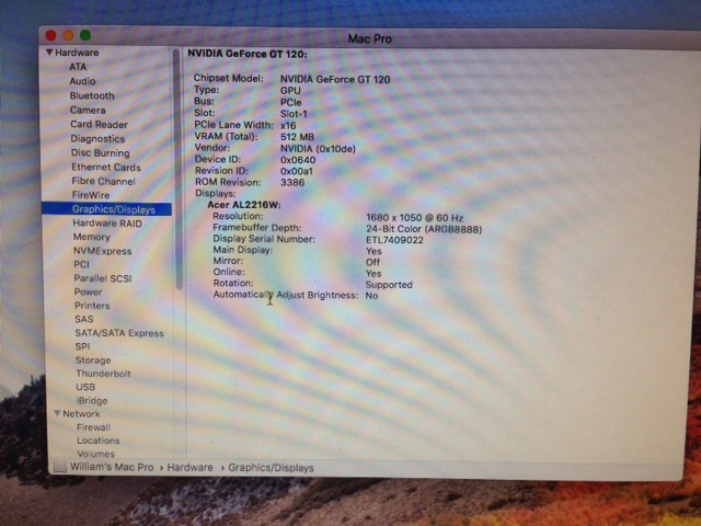

I have heard about software to control displays and such, Most of the time it is used when using high resolution displays or whatever with a powerful GPU.
I got rather curious as to how this software works and what it does, so I thought I would mess around with it in a situation where you would never use it just to see what happens.
I decided to try it out with a flashed to 5,1 2009 mac pro running high sierra with the stock gt120 GPU hooked up to an old 22" Acer display. I will show my results and you guys can form your own opinions.
I used cell phone photos of my screen so that people could see exactly what I was seeing and not photoshopped or anything.

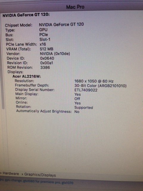

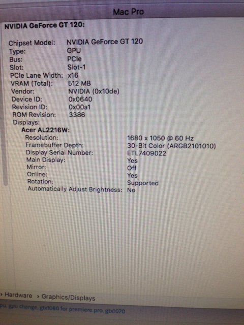

The weird thing is that even after going back to standard settings using RESXTREME it still said it was running 10 bit and did not revert to stock 8 bit until after deleting the software.

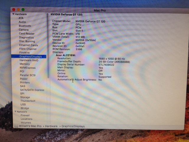

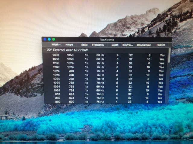

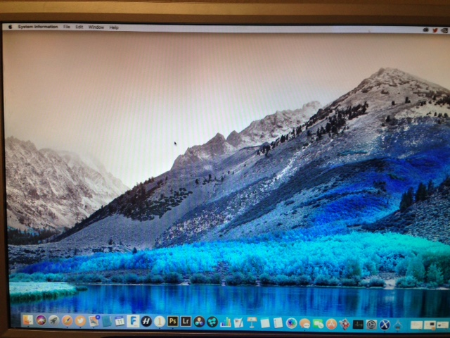

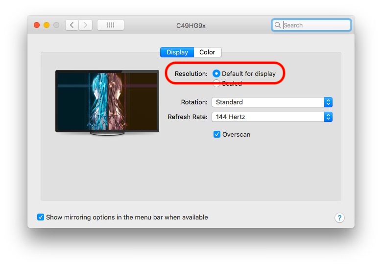

Use the following option to go back to 8 bit.

Believe me I was not expecting this to work, I was just playing around and wanted to share my experience. There was no serious expectation of a result here. I was more implying that if the software can show a 10 bit depth on hardware that has no where near the capability to even output depths like that then how accurate is it on other gpu's.
Think of this more as a reviewish type thing.
[doublepost=1510380156][/doublepost]For example, I switched it back to 8 bit using the software and the colour and screen all looked normal yet the frame buffer in the system report was still showing ARGB2101010
It doesn't. There is no difference.
All the data will be converted back to 8 bit before it goes back to your display.
Almost any GPU can process 10 bit data. But that's different than what's being output. And that will just get converted back to 8 bit.
You could do the same thing with black and white Macs too. Loading up a color image on a black and white Mac could be done. It would just display in black and white. Just because you had a color window didn't mean that your Mac magically turned into a color Mac.

I agree that is sort of what I was implying with my observation. That even though it showed 10 Bit frame buffer in the system report. That due to hardware limitation I knew I definitely wasn't. What I was implying was that while it shows one thing in system report via this software. The reality from the hardware is very different.
[doublepost=1510607806][/doublepost]What I'm trying to imply is there is no software magic going on. I had zero expectations of it actually doing anything. I was just amused at that even though I knew I had an 8 Bit hardware limitation it still showed 10 Bit in the system report. Which I new was not correct.
