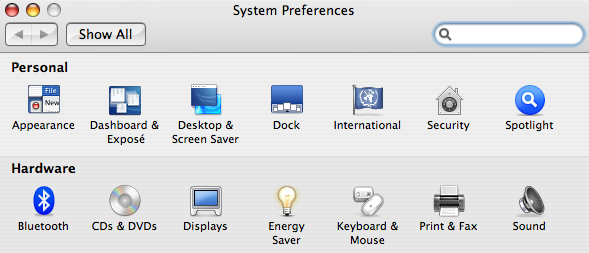

You should check your System Preferences under the CD's & DVDs for the rest of the issues.
