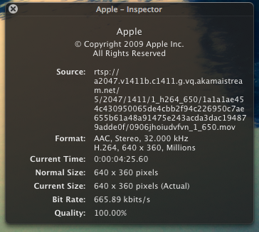

What process have you tried to accomplish the zipping? Have you used Mac OS X' built-in compress function? Or something else?
Btw, can you post details about the .mov file and what codec it does use? You can find out via the movie inspector in QuickTime.
You can take a screenshot via CMD+SHIFT+4 and then pressing the SPACEBAR and then selecting that window via mouse and attach that .png file, which is now stored on your Desktop to your next post via the Additional Options > Manage Attachments option below the text entry field.
If the codec is highly compressive like H264, you will only gain a 1GB saved space if anything at all.

According to Apple Inspector:
Format: Apple Intermediate Codec, 1440 x 1080
(1888 x 1062), Millions
16-bit Integer (Little Endian), Stereo,
48.000 kHz
FPS: 29.97
Data Size: 69.81 GB (apparently it's a bit larger than 64GB)
Data Rate: 85.54 mbits/s
