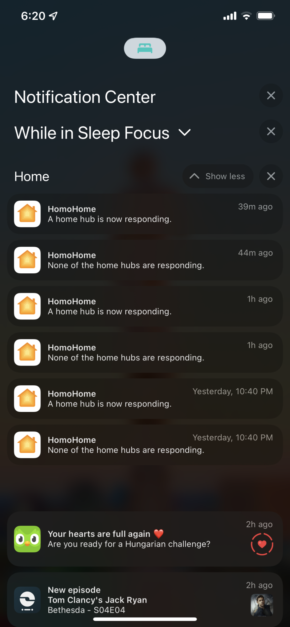

I have always had issues with my HomeApp, I CONSTANLY get notifications about a camera not working, or a hub/all hubs not responding. Would appreciate if you know anything about this
