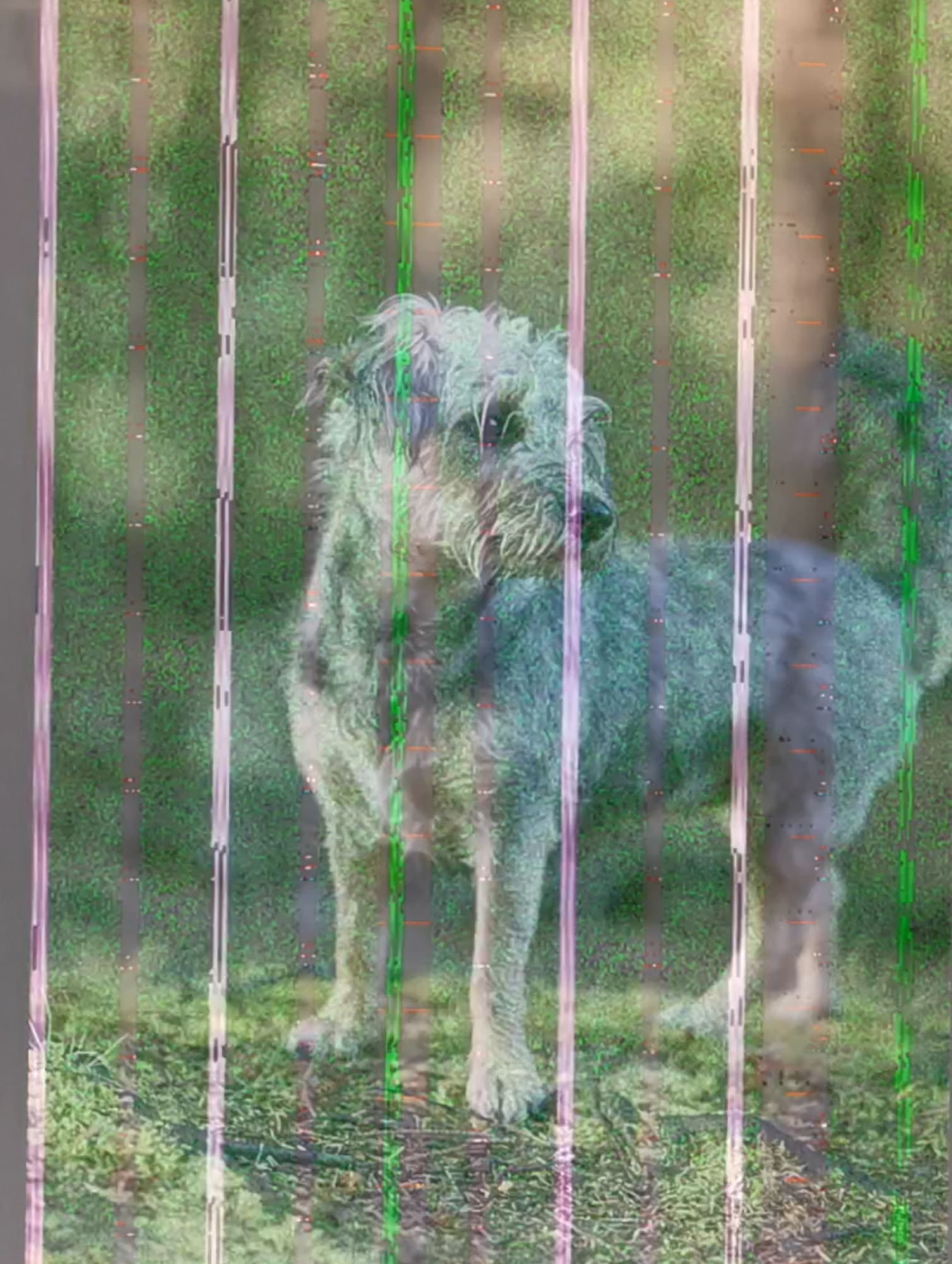

Bridge:

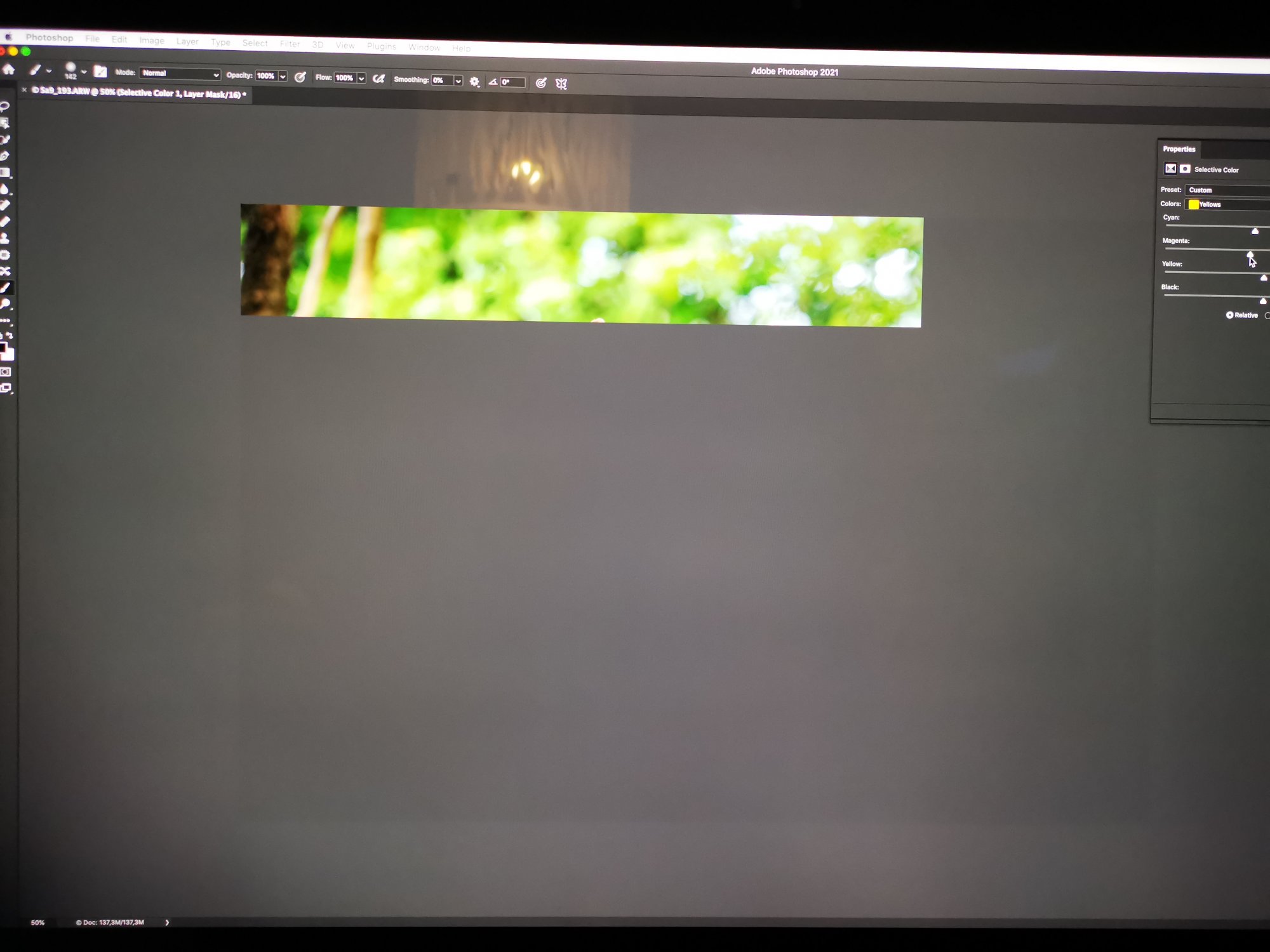

Selective color in PS: The top color - cyan, is dredfull laging, not even kidding, and all the rest are making the picture disappear when adjusting.....
Its much better when zoomed out to 50%. Its like its to heavy to process for something. Is it the graphic card? Sometimes its so slow, that I need to release the adjustment slider and wait for it to take effect.

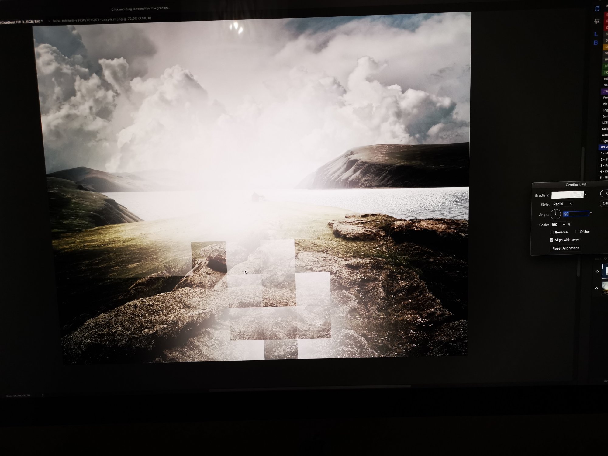

Gradient fill doesnt look any prettier..

You can test by plugging in an external monitor. If the glitches are on the monitor too, it's a gpu problem. Otherwise it's an imac display panel issue. You can also disable gpu acceleration in Photoshop Preferences-->Performance-->Use Graphics Processor.
No matter what the problem is, you have a lot going on there. If you're within the return window I would swap it for a new one. If not, AppleCare. I know it sucks to send a machine out but it seems like defective hardware to me.
