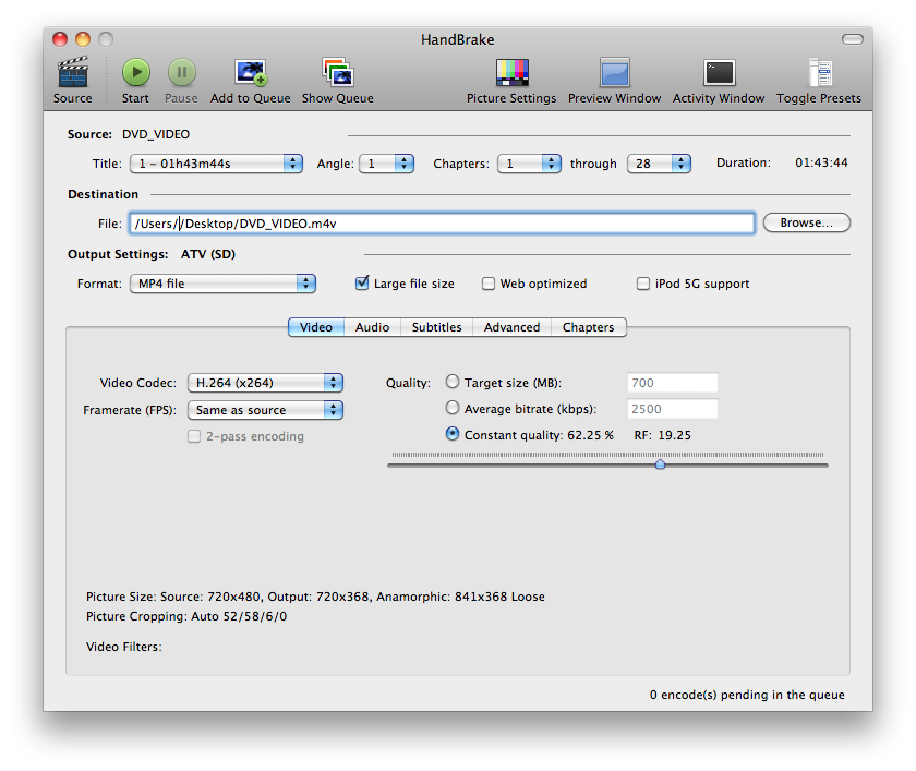

Ok, so my research into RF values is moving very very slowly. I'm just going to take everyone's word and assume that it's better than the Legacy presets with multiple passes. However, what is the best setting to use? I've read a lot about using Universal vs. AppleTV and/or iPhone presets. Basically I am trying to achieve this: I want all my Movies to appear in the best quality possible. I make two copies of each movie so that I have a smaller version that won't eat up space on my iPhone(and hopefully iPad, one day). I want the ones that I play on the AppleTV to be the best. So what do you guys use and swear by?
What picture settings do you use?
For example; I'm ripping "Wedding Planner" (for the wifey) and the original picture is 720x480, but Handbrake wants to make it different?
What is the best setting, knowing that I will be watching this on an HD 16:9 TV 99% of the time.
Thanks.
For the sd dvd's I leave it at loose anamorphic, same as the built in preset.
720 x 480 is the storage size not the display size. Just use Loose Anamorphic. If you want to know more about dvd's and storage size vs. anamorphic display size there is plenty about it in the HandBrake users guide.
All I have to say is WOW! Thank you and I hate you. Now I have to go re-do my whole video library. I'm stunned at what kind of quality I can get out of half the file size. Thank you thank you thank you.
Lol no problem. Just bear in mind that you should make sure you do not try those settings at the same rf value you use for dvds (19.25 ... awe hell just round it to 19) on a blu ray source. Remember to set it to about 22 or even 23 for HD input or it will kill the atv. Remember constant quality uses a logarithmic scale which is based on the quality of the input source. Know it and love it 😉
