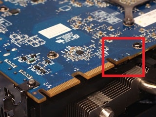

I had an issue where I couldn't boot into OS X with my 7970. After some investigation I noticed it was because the graphics card booted in UEFI mode. Likely, this caused a memory space conflict while loading drivers.
On my card, there's a little BIOS switch by the crossfire connector. It has two states, 1 or 2. By switching it, the card goes into either UEFI or legacy (BIOS) mode. BIOS mode was the correct mode for my MacPro5,1.
Later on I booted in UEFI mode into Windows 8.1, overwrote the UEFI part with a modded Mac EFI header for boot screens.
But, just flipping the switch is most likely sufficient in your case.
