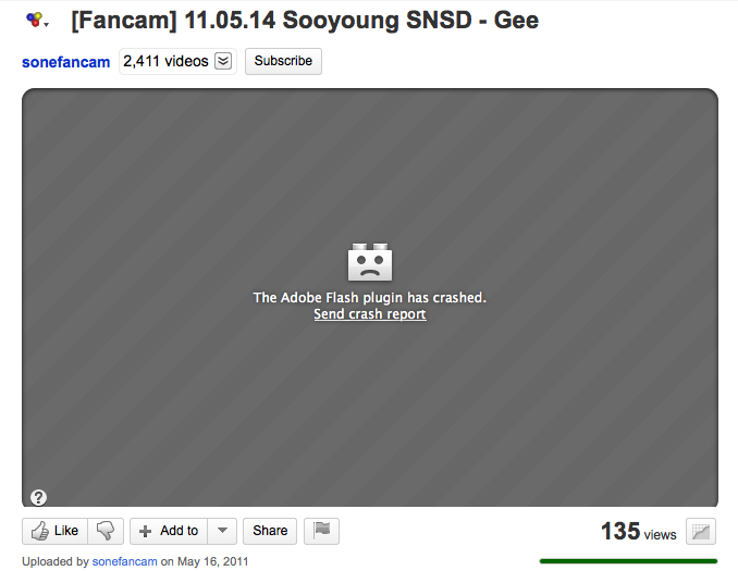

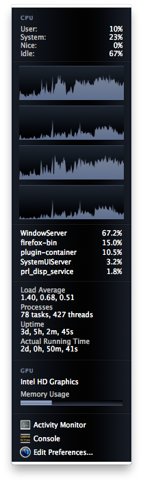

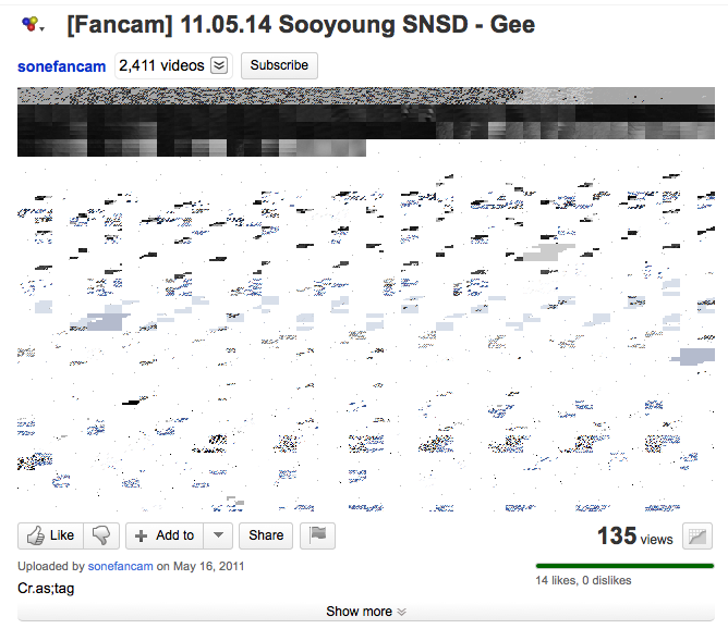

I would suppose, I never had the fans blare which was a huge relief from my previous 2006 MacBook. Down is a snapshots of the Intel HD. The fuzzy image is when I switched to Intel and restarted Firefox and tried to wach youtube. A few seconds later, I got the "Missing Plugin" error. Then after refreshing it played, and after letting it load, still stutters.
I did a test last night, opened youtube and did a search for 4k. Loaded up the water scene clip and played it at original resolution. It stuttered at first so I let the whole clip load and it was smooth as butter. Running at 4k resolution on the Intel HD GPU. Fullscreen or in the small window.

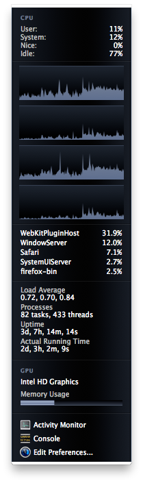

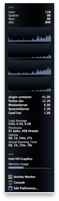

Below is a few screencaps from using Intel HD. Whats weird is when using the Intel HD, WindowServer spikes, but with the 330GT, Firefox itself spikes (usually 50-70%, but no sign of WindowServer)

@krafty
hmmm so weird, I switched to integrated graphics last night before going to bed.
When I woke up this morning I opened up my laptop and clicked a youtube link. I got the exact same "static" image in place of the youtube video. I could still hear the audio, but there was no video just the same exact fuzzy image you posted.

going back and switching to discrete, I get to see the video.
If I switch back to integrated I get the fuzzy images again in youtube.

It has something to do with Firefox, cause Safari plays it flawlessly.

This is really weird, maybe it's because I use the GT so much that the Intel HD just had too much vacation time and needed to start running. After letting it sit on Intel HD for a while, I decided to run another youtube video in Firefox and now its running smoothly. Only thing different is that I restarted my computer since the last run.
