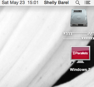

The Problem: The hard disk icon on the desktops top right corner (enabled by Finder->Preferences->Sidebar->Hard Disks turned on) usually titled "Macintosh HD" changed its title to a very long gibberish string. Other than that, I couldn't identify any operational issues with the iMac. For now ;-)

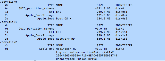

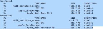

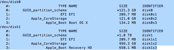

2. Applying "diskutil list" on the iMac:
While on the Mini Mac (healthy system):
You can see that on the Mac Mini (healthy) system "/dev/disk2" is mounted while on the iMac this mount doesn't exist! That may be related to the fact that "/Volumes" doesn't contain the relevant link (as described in (1.) )

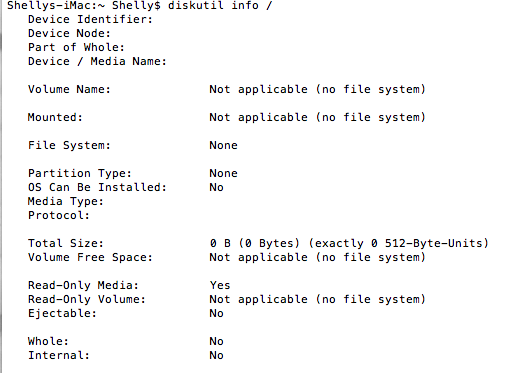

3. Applying "diskutil info /" on the iMac:
Looks very wrong... believe it or not this system works...

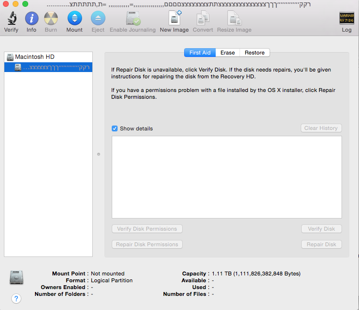

4. I didn't succeed to rename the disk icon gibberish title (the icon that is located usually on the top right desktop corner) back to "Macintosh HD". It stayed very long gibberish string. even "disk utility" didn't help. Each time I tried to change it the system produced an irrelevant error message telling me "The name xxx can't be used. Try using a name withe fewer characters, or with no punctuation marks"
5. "Disk Utility" behaves differently on the two systems: On the Mini Mac (healthy) system it shows a "Logical Volume Group" icon named "Macintosh HD" and under it, aligned to the right it shows another "Macintosh HD" icon for the "/" mount point.
On the other hand "Disk Utility" on the broken iMac shows alright the main "Logical Volume Group" icon, but underneath it, there is an icon with the gibberish title and the description below for that icon says:
Mount Point: Not mounted
Format: Logical Partition
Owners Enabled: -
Number of Folders: -
Capacity: 1.12 TB
Available: -
Used: -
Number of Files: -
