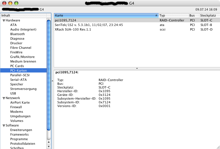

On the card identifiing itself as "SCSI":
that is usual, they all report back differently. My non-Mac SIL3124 card just says it is "RAID controller", my Sonnet says it is "ATA", my Macally card says it is "SCSI".
I have seen this in different forums with different cards as well and if I remember correctly it has do to something with the ATAPI version on the card???
See picture of my cards:
1. the non-Mac SIL3124 card, a PCI-X card
2. the Sonnet card (Sonnet uses the Firmtek/Seritek firmware, if you wonder about the name), PCI-card
3. Macally PCI card
