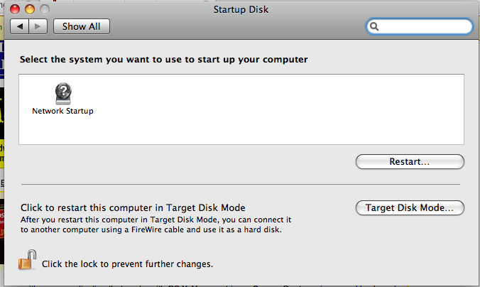

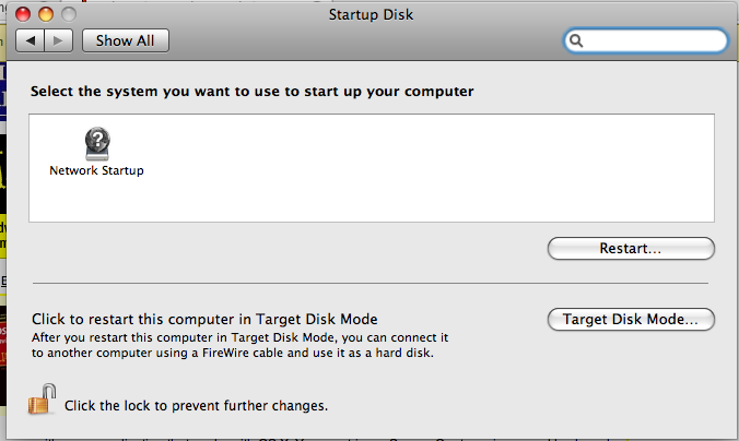

That's what I thought as well. The only option I have is "network startup". I wonder why the drive isn't showing up there.
Holy crap. I have never seen the Startup Disk pane without a real hard drive. You can boot from this hard drive, but it does not show up under Startup Disk pane???? When you initialized the drive, did you select the GUID partition table?
In Disk Utility, select the drive (and not the partition, which is below and indented), then the Partition tab appears. Under this tab, click the Options button and select GUID and initialize as OS X journaled. Then format the drive and use CCC to clone your original drive.
