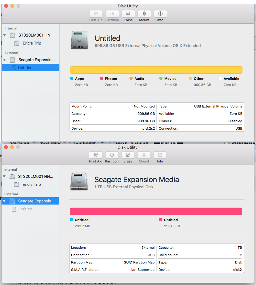

I've been using my External HD fine today, suddenly it doesn't appear in finder at all (i've checked preferences, It's ticked to show External HDs), so i've opened Disk Utl to try and First Aid it to see what the issues are, but it's just listed as "Untitled" can't first aid it (Greyed Out), and when I try to mount it.. it just... does nothing, no error message or anything (See picture Below)
As I say it was working fine earlier today, now it suddenly won't read, I haven't dropped it or anything in the interim. The light is on on the HD which means it's getting power, i've tried different cables, different USB slots, even a 2nd mac and nothing as of yet.

Have you tried running disk first aid on the disk, rather than the partition labeled as "Untitled"?

I have first aided the disk to no avail, I'd need to perform it on the actual expansion for this to do anything I'd imagine.

I feel that disk utility has been getting worse since El Cap. Have you tried mounting the volume with terminal or anything like that yet?
Also untitled is what the drive is named when it has been erased, are you sure you haven't erased it?
Try opening terminal and typing "diskutil mount disk2s2" without the quotes, and hit enter. See if that lets you mount the volume.

Also you need to check in the terminal diskutil list and see if the disk shows as two partitions disk1s1 and disk1s2. This will tell you if your partition map is damaged.
