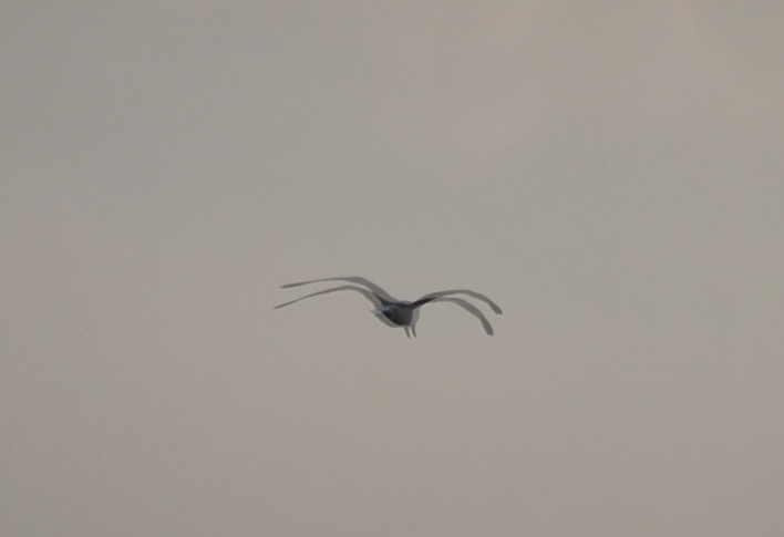

However, No matter what setting I export, I get a portion of the video 'layered' in a particular scene. It looks fine in FCP.
Here's what it looks like:

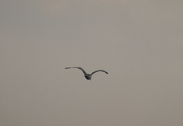

And here's what it SHOULD look like.

Well I import the 1080i .mts files via Log and Transfer using the default settings. The sequence settings are set up to use ProRes 422 30FPS
I export them with ProRess 422 at 1920X1080
Do you export them as interlaced (1080i) or progressive (1080p)?
Btw, FCP will not show interlaced footage with those lines in its preview monitors. And the TV will not show those lines too. A computer monitor will, unless you apply a de-interlacing filter in the application you play it with (VLC can do that for example). Have you taken a look at the manual on how to properly export deinterlaced footage?
I exported them as 1080p. I just tried switching all the settings to 1080p, and it still shows interlaced.
So ALL computer monitors without a program that has a de-interlacing filter will show those interlaced lines? How would I get around that?
EDIT:
Hah. I applied the deinterlaced filter in FCP to the clip and there's no lines. Good move? It looks pretty good to me.
