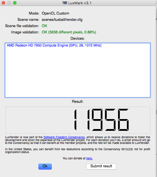

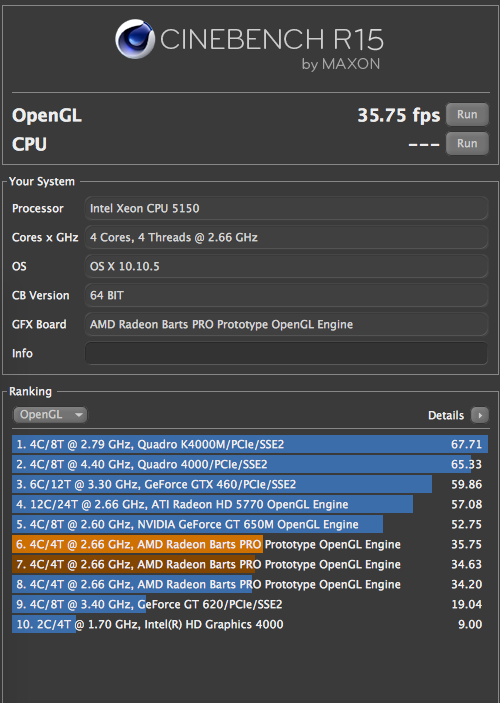

I've have 2007 Mac Pro 1,1 for which i bought a Sapphire Radeon HD 6850 to use with some light FCPX editing and few games. I know that PC Radeon card won't get me boot screens and rarely be recognized correctly, but i couldn't find anywhere is flashing important for sheer functionality of the card?
When i bought it I've tested it for few hours in Borderlands 2 and Arkham City just because i know that if GPU has problems they will show up in games. All went ok with maxed or nearly maxed out settings on 1080p. It showed no bugs, screen flashes or graphical glitches.
Then i tried to run some Benchmarks and ran into a few problems.

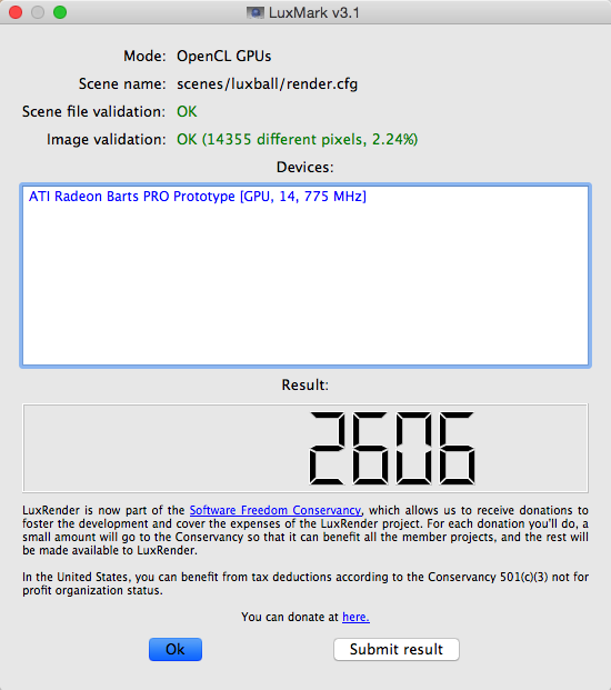

Luxmark and Cinebench seemed fine
Screen Shot 2016-02-17 at 3.06.03 AM.pngScreen Shot 2016-02-17 at 3.08.15 AM.png

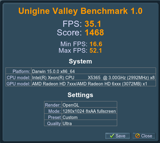

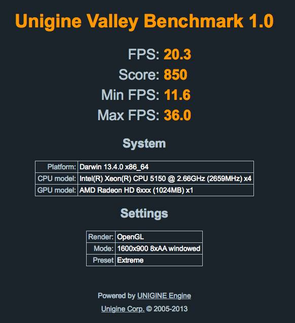

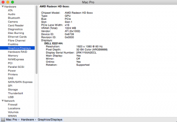

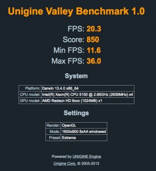

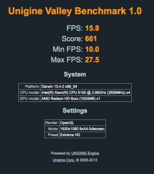

And so did the Unigine Valley
12674211_10153401709302957_1327371546_n.jpg 12722041_10153401709317957_264143082_n.jpg
Though I'm not sure if the results are OK?

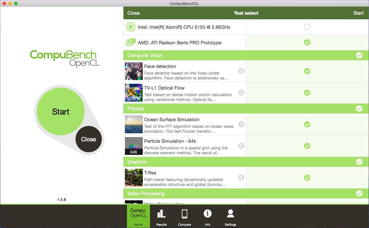

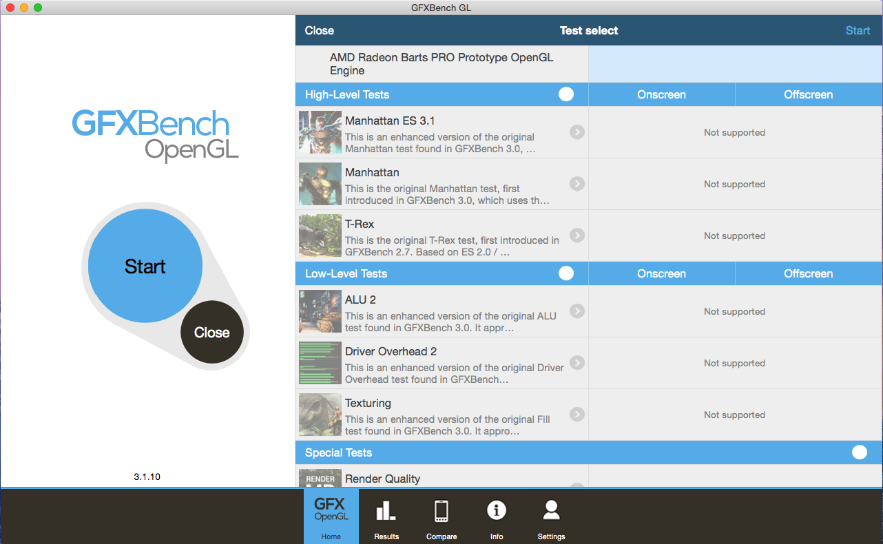

But i ran into a problem with GFXbench GL and CompuBench CL. The first didn't want to run (nothing was supported) and later one just loaded bench screens (YT video)
Screen Shot 2016-02-17 at 3.09.13 AM.png Screen Shot 2016-02-17 at 3.10.02 AM.png

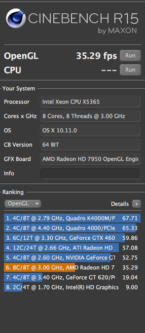

Here are some Testresults from the R9 280 on my MP2.1 running and ElCapitan 10.11.0 (possibly missing the correct drivers for the R9 280)
[doublepost=1544999316][/doublepost]Screen Shot 2018-12-16 at 23.27.22.png

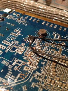

Hello , may i know how you did this?
I've soldered two wires to the pins and then was able to short them or take them apart while Mac was running (because you have to boot with those pin shorted, and then flash it when they are apart). It doesn't have to be a copper wire, just any wire that will conduct electricity. It is, however, smart to use insulated wire so you don't touch with it other components on PCB.
Found a picture, but this is 6850 by Sapphire
Reactions: mrkapqa
