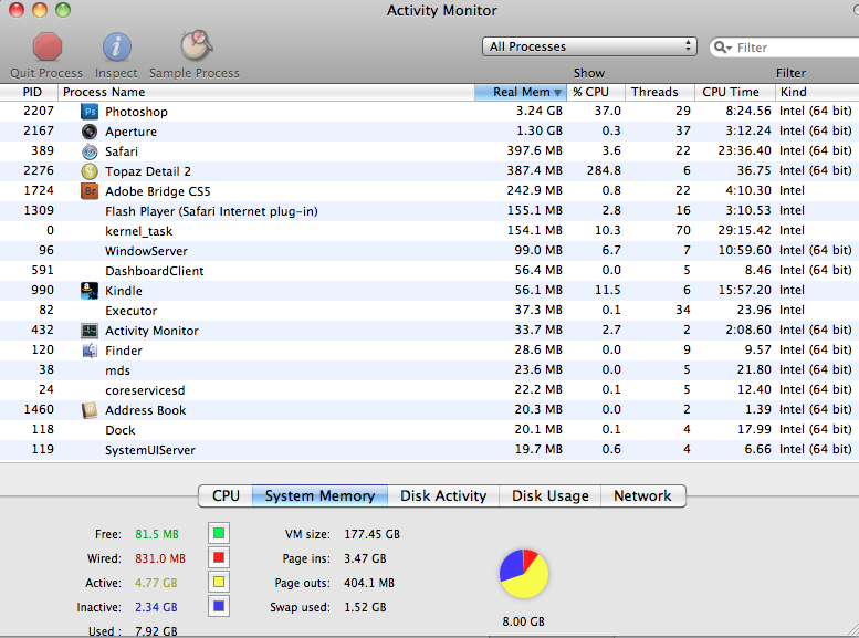

The short answer is it depends. The price of $59.99 is recent, last week it was $65 and last month it was $69.99.
RAM vs Drive speed/size for better performance depends on what you are doing. More RAM will be much more useful for 64-bit RAM hogging programs like Photoshop CS5 and will help a lot with Aperture - see attached screen shot below where I am using both and tapping out my 8GB RAM. For general use like web surfing or using iWorks the difference in RAM will be minimal. But, once you open a program the first time after booting up it should open faster the second time after you Quit it because with more RAM that program will remain reside in the Inactive RAM. One way to see how your RAM is going is to keep the Activity Monitor in the Dock and then go to View - Dock Icon and change it to Show Memory Usage. That will change the icon in the dock (after you click on it once) to a real time pie chart showing your current RAM use. Great way to gauge if you need more RAM. Also, check the Activity Monitor for Page Outs. If that number is in the GB range after you open and use the things you use, then you can benefit from more RAM instead of using the slower hard drive for scratch.
Regarding the hard drive performance. Part of the difference is how much or your hard drive you are using. If it is over 50% full and closer to 75% or more, then a bigger hard drive will increase read/write performance. The more it is full (assuming the same data density and speed) the better the performance enhancement. Higher spin rates of 7200 vs 5400 or roughly 20% for the same size and density drives will alleviate that potential bottleneck. The more the drive fills up and the more the data is read or written in the center of the drive vs the outer part, the slower the performance. You should see noticeably faster boot times (not SSD like) and programs should open faster because of the faster read times.
Bottom line is you will get faster performance but it depends on what you are doing because different tasks have different bottlenecks. Sometimes it is about the CPU, sometimes it is RAM and sometimes it is Read/Write (hard drive). Having plenty of RAM and a fast hard drive will make things run smoother. For most of my Photoshop work more RAM made a huge difference - see below.
