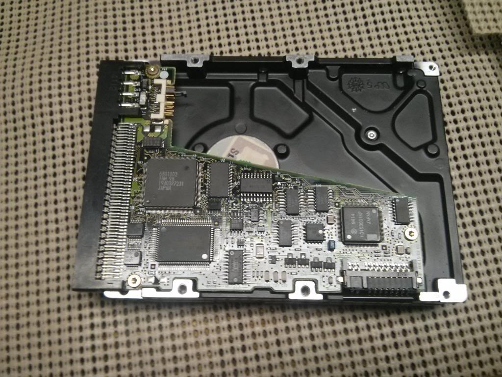

How would one go about warming up the drive..? I left it on overnight thinking it would warm up itself, but it didn't. Do you think putting it in the fridge would be a better idea? I tried pressing on some of the IC's, but no luck. Just for fun, I've included a pic of the circuit board on it.
How would one go about warming up the drive..? I left it on overnight thinking it would warm up.....
An IR heat lamp at a safe distance would warm it up just fine. But I doubt it would have any effect.
There is a small chance the failure is in the logic board and not the drive mechanics. If you are lucky and this is the case then the trick is to buy another IDENTICAL disk drive, test that is works and swap logic boards.
I've seen a board swap work on older tech drives that are no longer made. Of course the fires thing you do if the drive works is copy all the data to a backup, twice at least. Then replace the drive with a brand new one and restore the data.
If the failure is mechanical you do about the same thing, first find an IDENTICAL working drive and disassemble the platters and swap them. This is not an easy job and you need a clean room, hair nets, face mask, latex gloves and so on. Better to pay someone who is set up to do it.
But why bother? buy a new drive and get the old OS off a bit torrent
