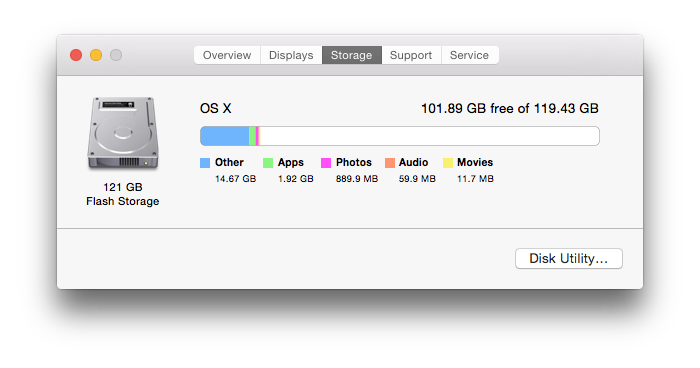

Since I updated to 10.10, my free space keeps dwindling slowly after I boot up, until it eventually goes down to 0. Is this happening to anyone else?
Mine is still looking ok. I'll check back in a few days to a week and see if anything has drastically dropped.

I think if you had the issues it would have seen them by now. Must be just me.
