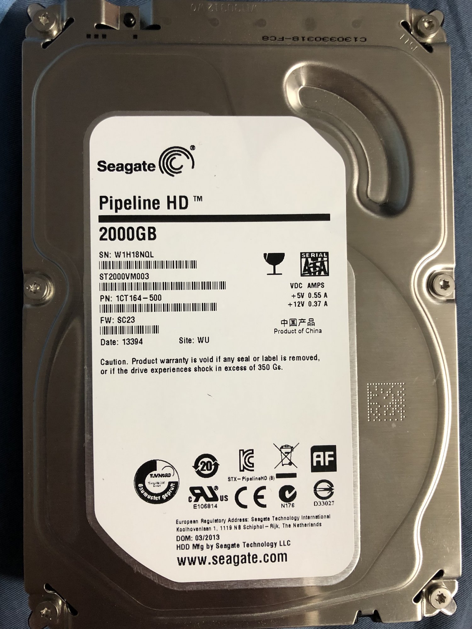

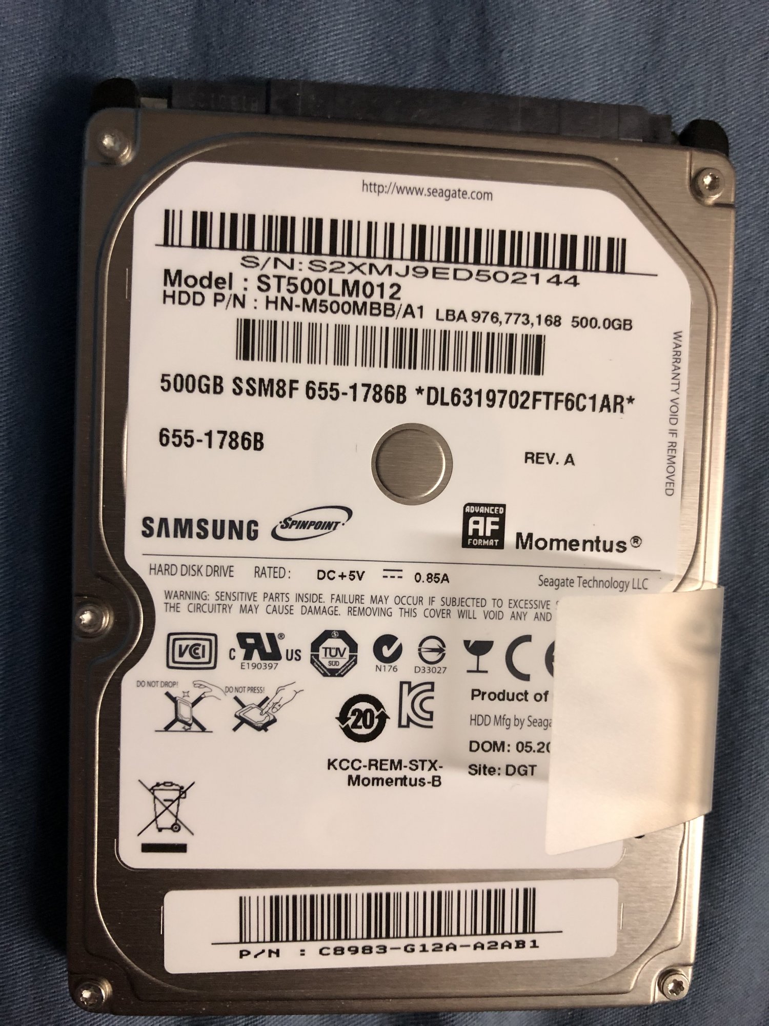

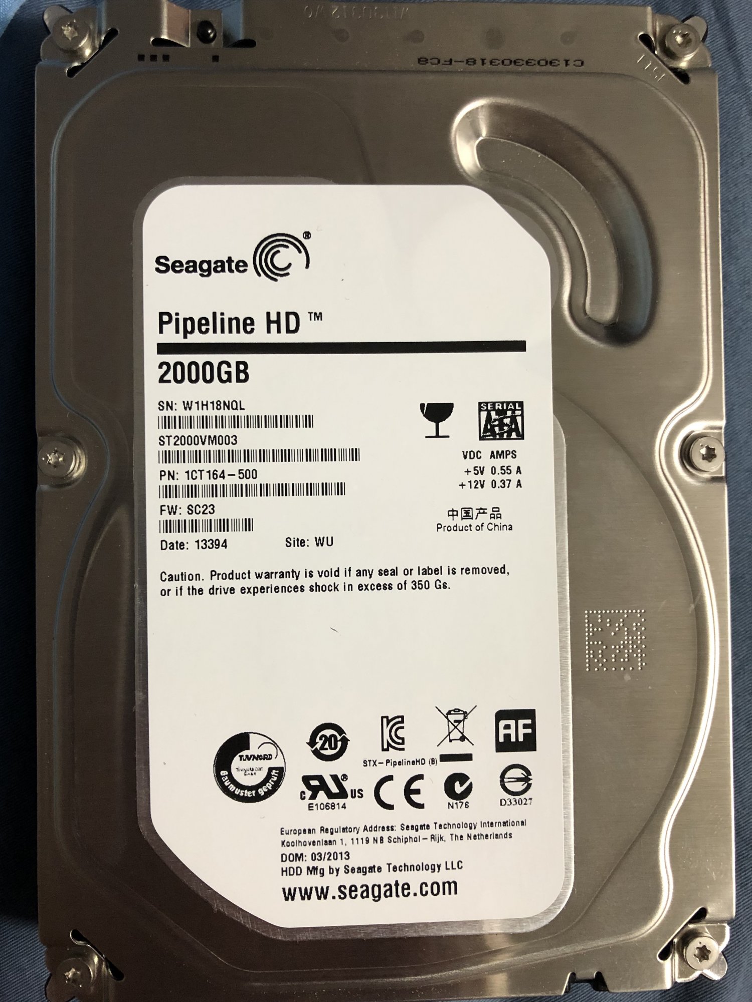

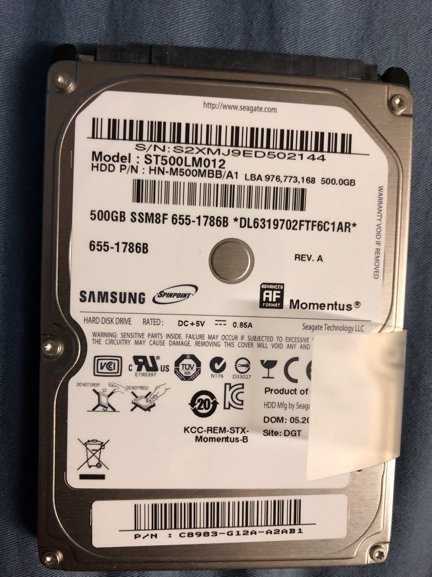

Hi USB3foriMac,
What model? Powered how? Voltage?
What disks? Spinning HDD or SSDs? A photo of the disk label might help, too.
Model of Dock Station: https://www.orico.cc/usmobile/product/detail/id/3551
Disks images as attached.

You are not showing the power adapter you are Cs, too) using for the dock.
Two things:
1. The power adapter is 12V. This is only to provide the 12V power needed for spinning HDD. The 5V still come from USB!
2. Both your disks draw more than 500mA from the 5V. Older Macs (and PCs, too) were very strict and do not deliver more than 500mA on USB.
So what you can do is try to add a powered USB hub which comes with a separate 5V power supply. If it's a newer model, it will likely deliver more than 500mA. So one might work, another might not.
The 2.5" HDD only uses 5V, no 12V, and the current draw is even higher. You could try a powered USB3 hub if such thing exists.
Another alternative are those double-cables. Two USB A plugs into a single USB cable. They uses to come with those external 2.5" housings years back. That should do the trick, too.
