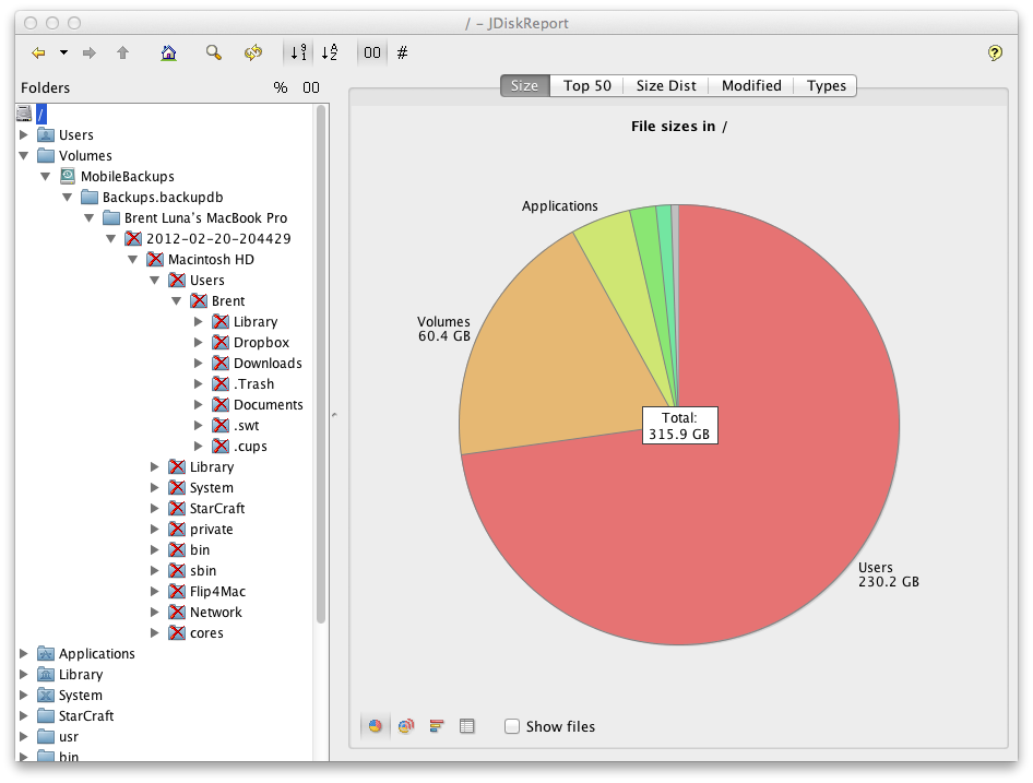

So i ran Jdisk report to determine what my space is looking like. Can somoene explain the volumes section, and why its taking 60gb? Will that be something i'm trying to clone over to the SSD or will I be leaving it on the HDD and creating a symlink for it?

It seems that is your timemachine backups.
Try DaisyDisk. The trial works for a few times for free and it offers a better gui. Volumes is just the unix mount point of all partitions. It is odd that it reports it.
It looks like you have only some 25GB of data that you need on the SSD. That seems like your apps actually need very little space and Lion less than I thought.
You also don't need to use such an apps at all. Just move the Movie, Picture & Music folder and delete what is in it. What is left will be some 30GB as it seems that easily fit on the ssd. How much space is used finder tells you just fine. Apps like DaisyDisk, JDisk.. are just to show you where you waste all your space and help you decide what it costs in space used to have certain folders on the ssd. Or just to show you for the first time what uses how much space. My father still doesn't believe me, no matter how often I tell him, that a book on a tablet needs a negligible amount of space. And if you take computers and a storage medium past 50GB nothing matters for space used other than Music, Pictures, Movies and Games.

Strange that its showing it as time machine back-ups, since i believe i only started using time machine when i got my external HDD. Do you think I could just delete it?

You cannot delete the Volume folder. It really just is a mount point. I guess you come from Windows. Unix file system is little different in a way less common sensical than windows. There isn't actually anything in the Volumes "folder". It is just links in a way.
You'd have this time machine partition or image wherever it is actually saved. DasiyDisk doesn't report the Volumes folder as a folder with data in it and finder hides it for good reason. It just confuses people. In finder the Devices panel on the top left is effectively the volumes folder.
