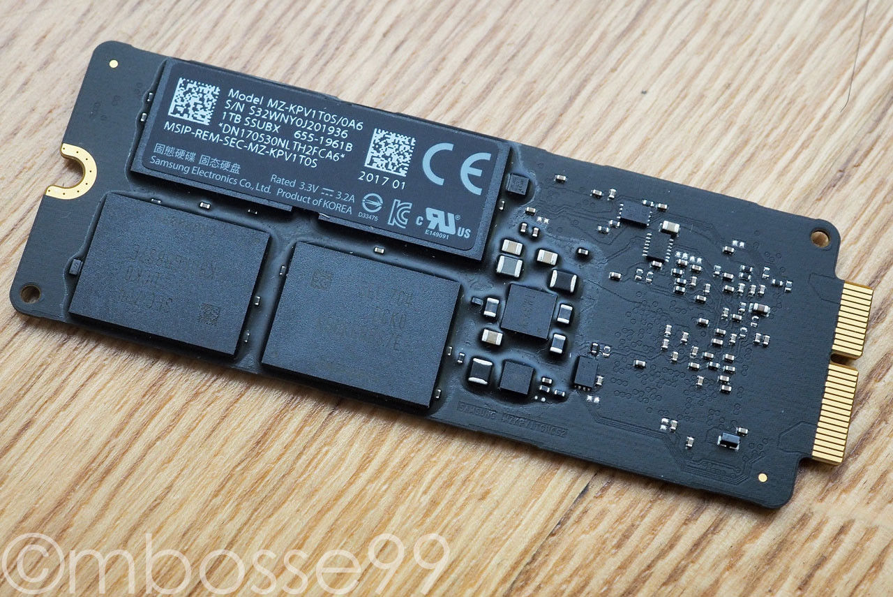

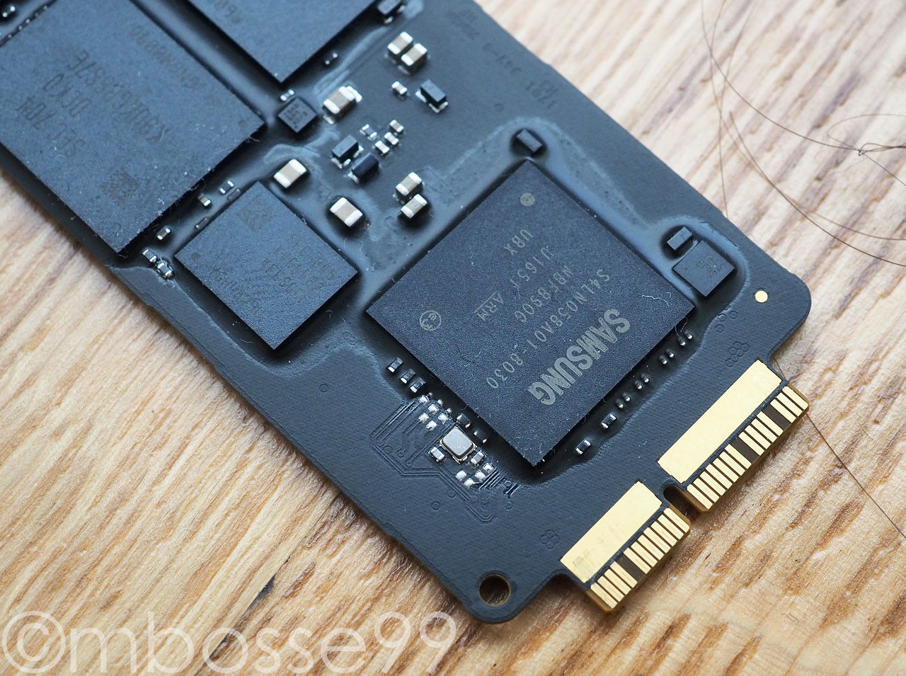

Any Apple PCIe SSD would do (look for a Macbook Pro Retina (Late 2013 up to Mid 2015), Macbook Air (Mid 2013 or younger) or Mac Pro (Late 2013) SSD), you can source them from Ebay.
They look like this one (brand can be Samsung, Sandisk or Toshiba):
Best,
Magnus
