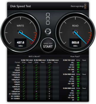

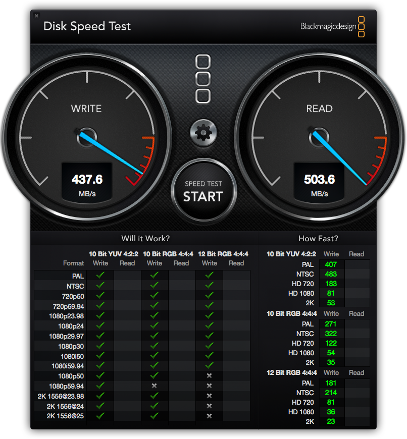

I also have a MacPro1,1 and use 2 Samsung SataIII SSD's in a raid0 as my boot drive.
This gives access speeds very close to a Sata 6GB SSD as shown in the Black Magic result.

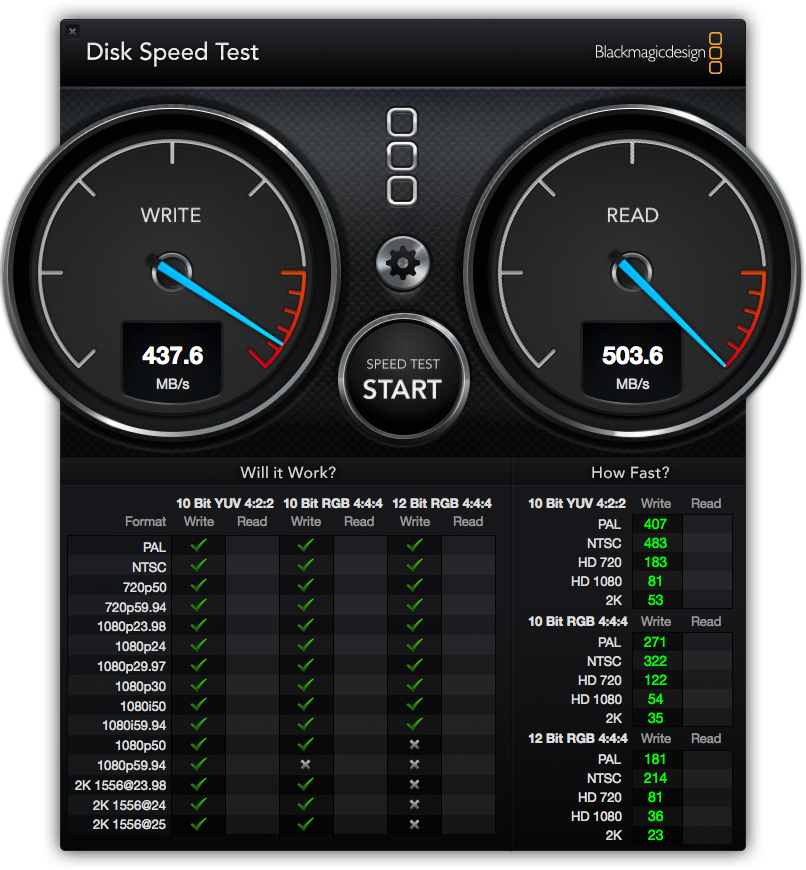

This is about the best I've managed to come up with so-far, but the search is never ending.
Note that for a boot drive, especially while booting, the system does lots of small IOs scattered across the disk.
No issue for an SSD, but much slower for a spinner because head delays are part of the test.
Black Magic, as you'd suspect, looks at the performance of reading and writing huge video files.
Is it at all surprising that a pair of 3 Gbps SSDs in RAID-0 "gives access speeds very close to a Sata 6Gbps SSD" on sequential accesses?
Not even Einstein would have guessed that 3*2 was about the same as 6. 😉
Actually a pair of 3 Gbps SSD's did not give me the speed I was looking for,
it took a pair of SataIII 6GBPS SSD's to achieve that.
But I'm sure Einstein would have figured that out too, given enough time.

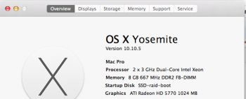

Thanks jbarley. I like the idea of a raid 0 for some extra speed but I'll probably just keep it safe and simple with one. I'm curious, do you run an updated version of Mac OS? I know the 1,1 macs are 32bit and not able to run new versions of Mac OS without some creative fixes. I managed to get 10.10.2 up and running but I'm afraid to try and run updates. Wondering if you've had a similar experience.
my MP1,1 is fully updated to 10.10.5, I used the "PikeYoseFix" script found in post#1 at this link.
Since downloading and installing the script (I chose the black boot screen) I've had zero issues with updates.
