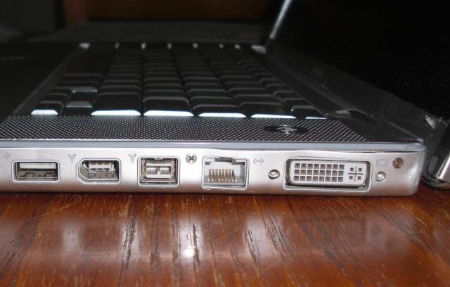

Here is what the ports on his mac book look like:
Is there an hdmi adapter for one of these ports? If so, do you have a link to a site that sells it?
DVI-->HDMI is what you need, I'm pretty sure it won't support audio though.

Actually, let me back up a second, I would start with DVI--->VGA if his TV has a VGA connection, an older computer is likely going to struggle with HD resolution [which is the most benefit to hooking up through HDMI].

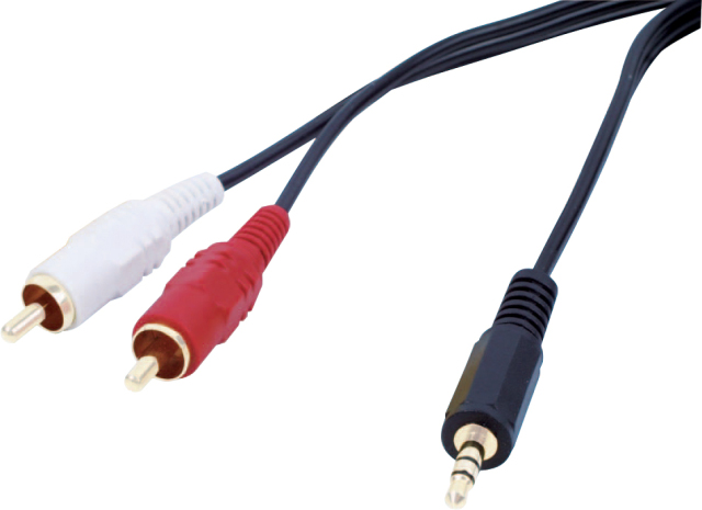

Use audio cable male to male should work one end of the cable from mbp audio jack to tv audio jack, should do it.

Anyone know what kind of cable I need for the audio?

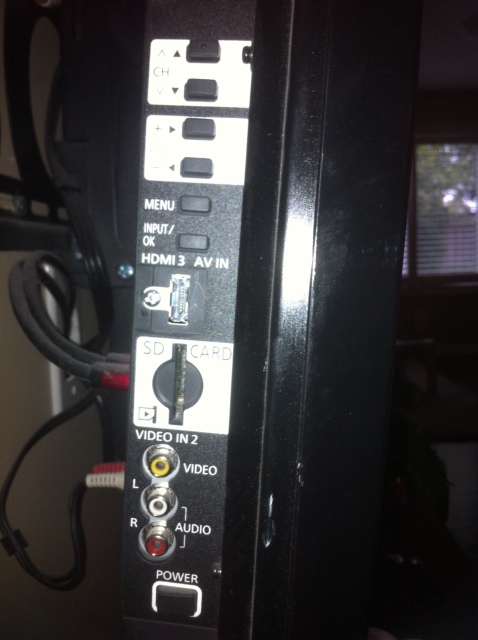

So I had my bro in law look at his TV. He said he didn't see a VGA port. But there are definitely audio/video jacks and an HDMI slot as seen here:
So as someone suggested before, I think I'll need to try DVI to HDMI adapter. And then run audio cable like this:

Audio cable:
http://www.monoprice.com/Product/?c...d=1021815&p_id=5599&seq=1&format=1#largeimage
When he plugged in the video cable and pressed Input on the TV to "Other", the video immediately worked and his laptop was displaying on the TV.
However, the audio is not working. It's still coming from his macbook even though the audio cable is going from his headphone jack to the correct colored audio jacks in the TV.
He has pressed input several times to go from different modes on the TV back to "Other" and still the audio won't come form the TV.
He has tried plugging the cable into both of those audio jacks on the macbook.
Is there some setting that has to be changed on the macbook to get the audio to pass through to the TV?

I don't believe you can get audio on the TV the way you have it as the video is going to the HDMI input (video 3), but you're sending the audio to a different input (video 2). You'll need the all in one adapter. It's odd that the audio is coming from the MBP even with a cable plugged in as it should think it has headphones or speakers plugged in.

you could be right. i wish someone had told me this on the 3 forums i posted to regarding this. everyone said this original set up should work. now monoprice said the same thing about the all in one. wish they had told me too because i specifically asked them if this set up would work and they said yes.
