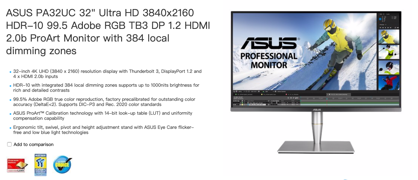

A 4K display at 27" or higher will not be as sharp - again, that starts to be a television intended for viewing at 10' away.
Where do these ideas come from?
Eizo, HP Dream Color, Flanders Scientific, Panasonic, Asus, etc. all make 31"-32" 4K monitors that are used for high-end professional image editing and colour grading. They range in price from about US$2000 to tens of thousands. To take one example, the Eizo, a highly regarded industry standard, is $6000.
It's news to me that all these monitors, including my Asus ProArt 32" 4k monitor (photo below), are essentially unsharp televisions that should be viewed from a distance of 10'.
