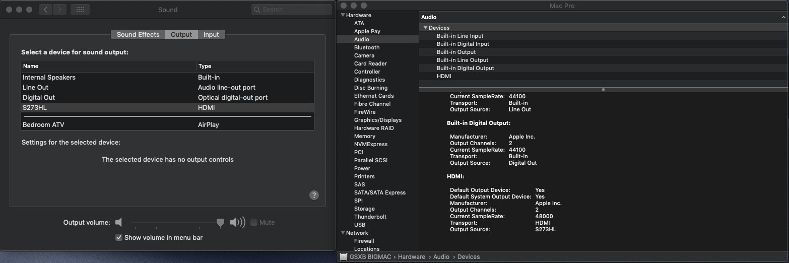

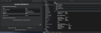

[doublepost=1543867731][/doublepost]success now have hdmi sound

worked for following video card on Mac Pro 5.1 with Mojave OS.
ASUS GTX 680 OC II - 2GB D5 without any issue!
THX A LOT for this one!!!

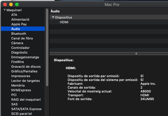

Followed the procedure stated on this post ( including the extra kext for NVIDIA ) on a Mac Pro 3.1 with GT710 and it worked. MacOS 10.14.2.
The only side effect is that all other audio out devices disappeared so there is no option to use the optical or analog out either the internal speaker.
Regards
