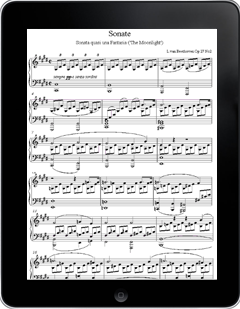

Trying to upload images to show what I'm talking abuot
HDTV photo Portrait w Music.pngI have done some mock-ups to show what I'm talking about here. One is an iPad in Portrait mode with some music on it. The next is an HDTV, connected via HDMI, with the music. The 3rd is what I want: the HDTV turned on its side, and the music better filling the screen (using more pixels). I can't seem to achieve this. When I rotate the iPad itself to Landscape, with most any PDF display app, the sheet of music gets smaller and is in the middle of the screen. Hope this helps!
