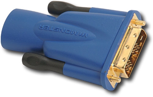

Right. Shouldn't the DVI to HDMI adapter have only DVI-D pins? Look at this one:
No analog pins that I can see. Got that from Best Buy. I think most DVI cables are of the 'D' variety anyways. It would be silly to have an 'I' cable for a digital signal. So I understand your point, but I don't think it is a problem in this situation.

Now that will work just fine.
You are quite right that a HDMI adapter would only require the DVI-D pins. At least with the adapter I suggested you'd be able to get DVI-I for both analog and digital options.
